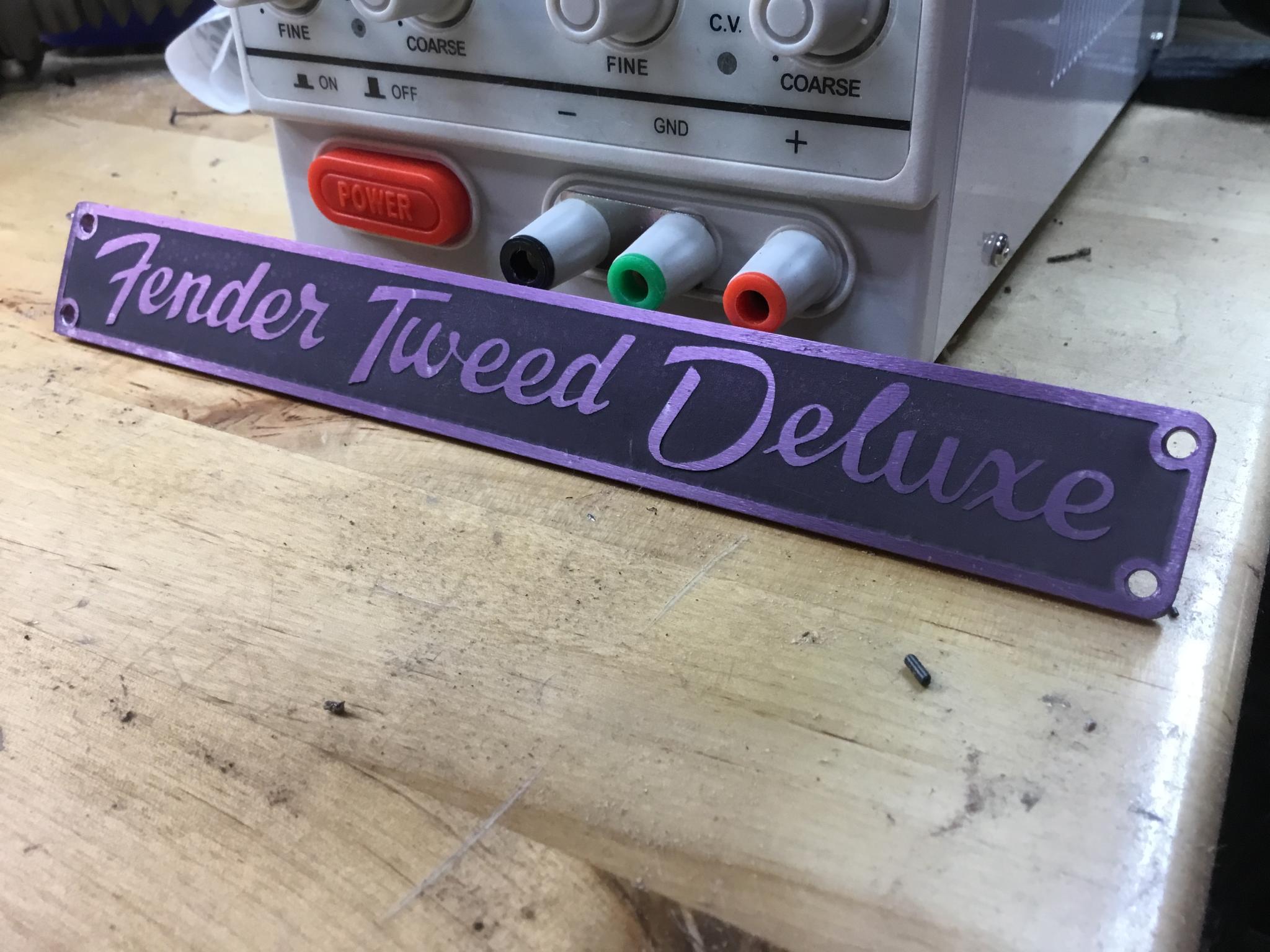

I crossed the streams! I wondered, what would happen if I took an electro-etched part and anodized it?
Voila! This is just a scrap piece I had sitting around, and it was fairly well oxidized. I didn’t want to sand it clean because I’d scuff up the dark bits, so it didn’t anodize very well as expected.  Had I done the two procedures back to back instead of letting it sit for months, it would have worked much better. I also didn’t work very hard on getting a solid electrical connection.
But as a proof of concept, it’s perfect. The dark etched bits are (I think) full of aluminum oxide and are effectively masked. This opens up some interesting possibilities.
