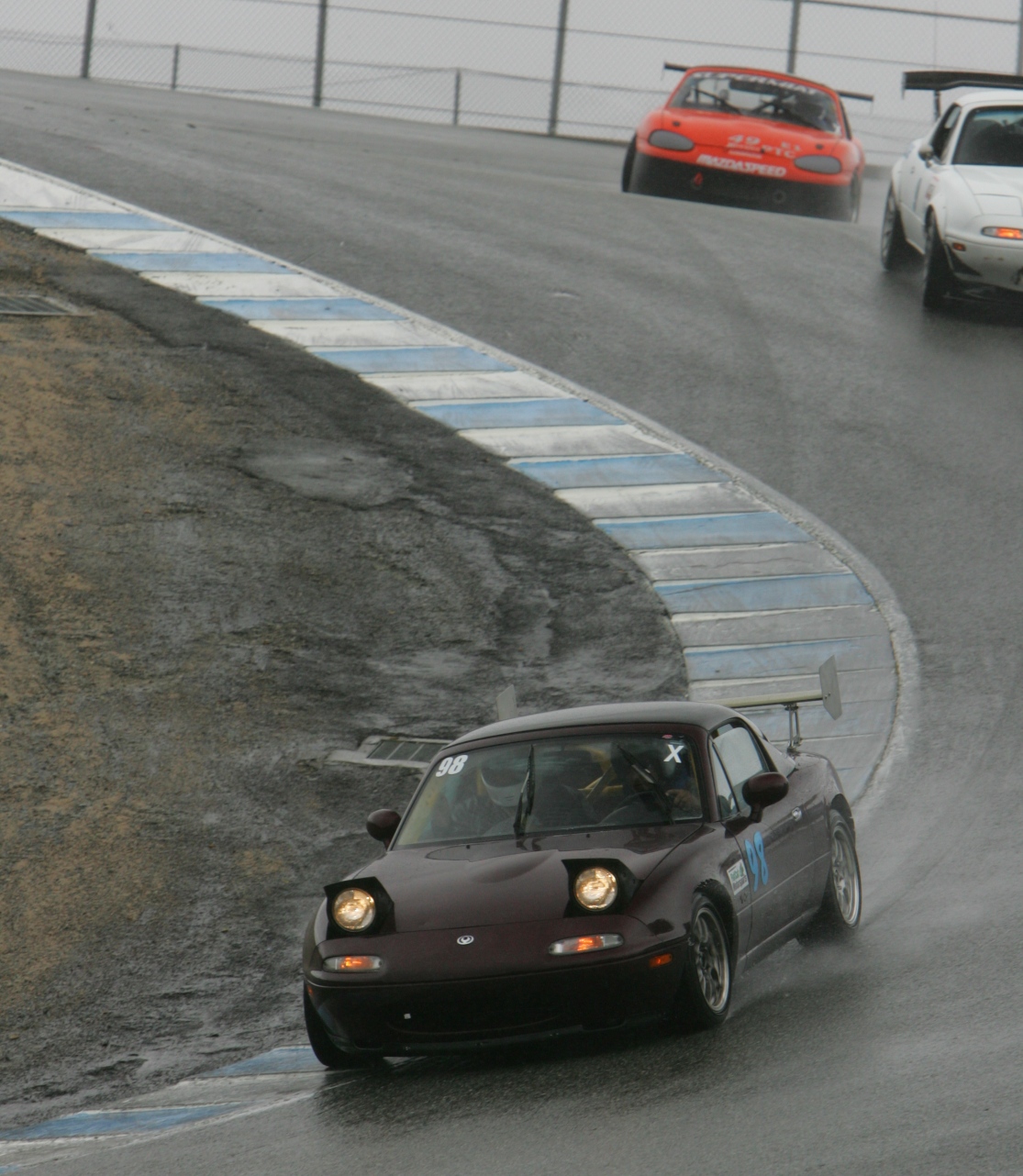

I had 'Senna', our '95 M-edition Miata, at Mazda Raceway Laguna Seca for the big Miata event earlier this year. I drove in off the street with a 1000/500 FCM Elite 3140 setup and 195 Toyo R1Rs, gaving rides both Saturday in the wet and Sunday in the dry. The car had no sway bars and worked incredibly well. No one could guess what spring rates we had although Laguna is rather smooth but even on the street the setup is surprisingly compliant. On the track it was just smooth, settled, predictable, and so easy to go very fast - as fast as 110whp will take you!
