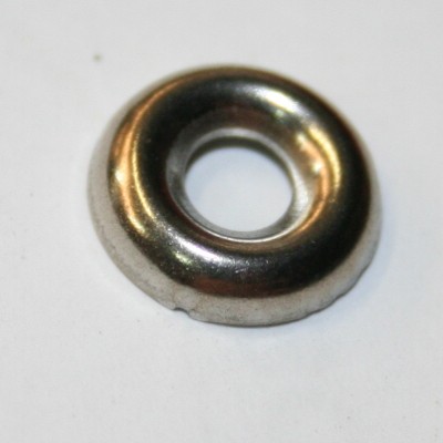

Wouldn't carriage bolts going all the way through the 2" square tube weaken it, aka stress concentrator? Do screws carefully located (so you find them again when replacing the wood) with some kind of cup like washer.
