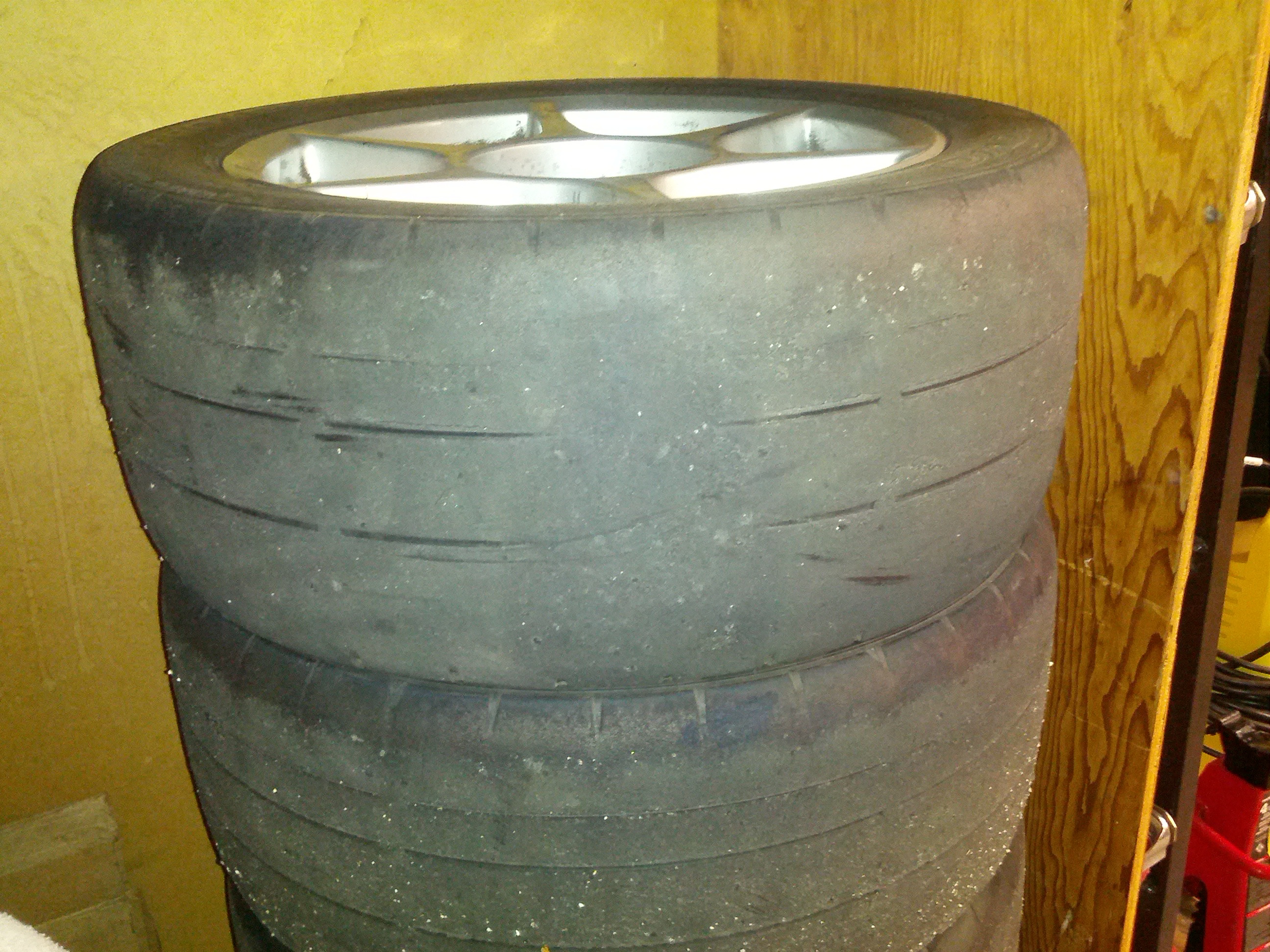

8/19/13 10:51 p.m.
Kenny_McCormic wrote: I fail to see how ABS is going to reduce tire wear without setting it sensitive enough that it will reduce performance.
ABS certainly reduces the likelihood of flatspotting and ruining expensive race tires.
That was my front right going into turn 11 at Laguna earlier this year, it's corded on the inside edge.
I'm putting an 2003 ABS system in my 99 (build thread on miataturbo.net), which is supposed to include EBD electronic proportioning. I'm not sure how that compares with the Wilwood prop valve, though.
