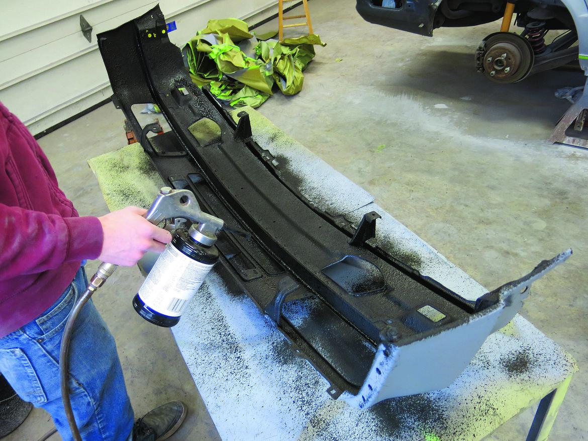

What brand of rubberized undercoating is that? Gun settings, nozzle size?
I am about to do this under my hot rod project.
Before the actual painting can begin, the lower portions of the car need some extra protection. Start by spraying the wheel arches and underside of the front valance with rubberized undercoating. While most people buy this stuff in aerosol rattlers (around $8 to $12 apiece), we’ve found that it’s faster and less expensive to invest in a $30 sprayer and source the underrating in cans (typically $15 per quart).

maschinenbau (I live here)
maschinenbau (I live here) SuperDork
5/14/20 11:51 a.m.
I'm curious if I can thin and spray it from a HF gun with 2.0mm nozzle. Looks like Eastwood has a good product, but they also want to sell you a special gun for it...
5/15/20 1:28 p.m.
FYI I bought a couple spray cans of the Eastwood stuff. I don't have much surface area to cover, so I figured it's not worth buying the gun.
I'll put results in my hot rod build thread once I get to that step.
https://www.eastwood.com/eastwood-rubberized-undercoating.html
