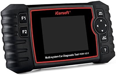

I got this one for my 981 Cayman:
ICarSoft
It reads all the codes and I used it to reset my oil change indicator.  It also looks like you can use it for ABS service mode.

This one?
iCarsoft Auto Diagnostic Scanner POR V2.0 for Porsche with ABS Scan,Oil Service Reset ect
Jeff (Gearheadotaku) brought one of those over a few weeks ago, and it couldn't read anything wrong, but after clearing codes with it, the car started, ran for about a second then stopped.  That's when we tried plugging in a dead OBDII Dongle and discovered that as long as something is plugged in, the car will start and run just fine, other than the temp sensor issue.
I guess that I need the real deal.  Does the $300 cable/software kit limit you to three VINs? What's the cost for unlimited VINs vs thee VINs?  Does the cable software limit the number of computers it can be installed on?
