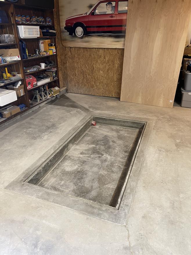

Nicely done.  I essentially built the inground version of this, but have yet to buy the lift.
put a lip in concrete for a piece of plywood to sit flush with floor, and a recess for the lift itself to sit under it.  Figure it acts like a nice table top bench when needed, or otherwise allows a clear floor when not in use.  Ran conduit under concrete to wall as well for the hydraulic hoses to keep floor clear.
