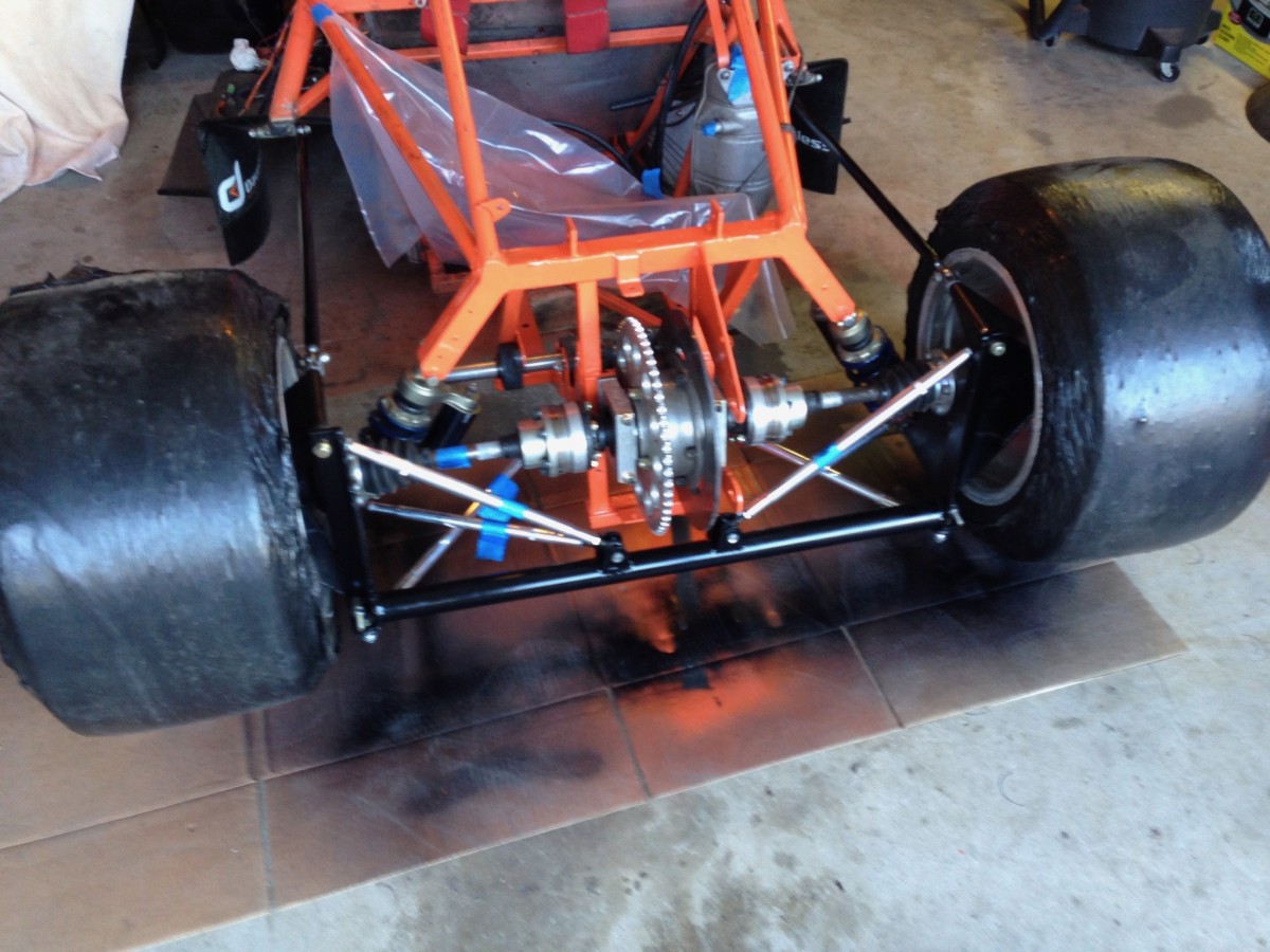

I honestly believe a well engineered de Dion setup could be as light or lighter than an equivalent IRS. Most all the de Dion pictures I can find depict de Dion as having a large, heavy tube spanning the width of the axle. However this can easily be replaced by a very light and stiff steel tubular framework that's three dimensional. I once saw a picture of a very elegant setup (I believe it was a Ferrari Lemans prototype car?) but I can't find it now.
Here is a decent system IMO. BTW, this is currently the fastest autocross car in the country. This lets you adjust camber and toe just as easily as an independent system too.

1/12/18 9:08 p.m.
I really, really like that. That is a very tempting way to go on Locost #2.
Thanks for posting this. I am generally a proponent of the DeDion rear and had thought about similar such adjustable configurations before, including connecting it to the chassis via Satchell link, but had never seen one as such in practice.  Very cool.  I am somewhat surprised that they were able to get away with putting the bending loads from the toe and camber links into such a small diameter tube, but it's obviously working on that car.

freetors
freetors New Reader
1/13/18 8:39 a.m.
Driven5 said:
I had a think about this and they may be have designed in some compliance/flexibility so that they get some camber gain in cornering. It's definitely not the stiffest way they could've built it. They could have run a link laterally across the top. But then camber adjustment method has to change.
That car produces over 1000 pounds of downforce (possibly much more, only the owners know the truth) so the cornering loads would be massive.
