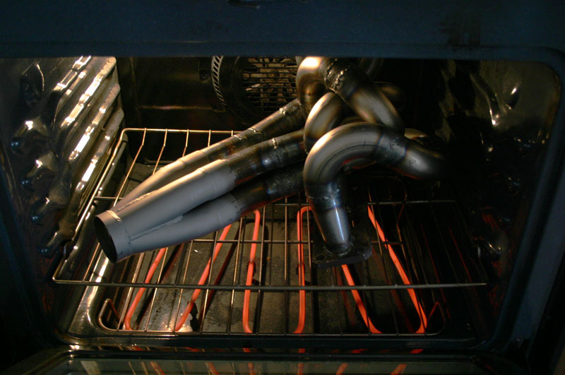

7/28/10 7:24 p.m.
Look at your fence pipe. Now look at me. Now back at your fence pipe. Now back to me. The fence pipe is now a turbo manifold.

You can get in trouble for heat-treating your header in the oven too. Weird.
John Brown
John Brown SuperDork
7/28/10 10:08 p.m.
A convection type oven as well, no wonder she was mad ;)

Sometimes its nice living with a bunch of car guys.
Keith
Keith SuperDork
7/29/10 9:54 a.m.
Hey, I degreased it first! Anyhow, enough of that. Back to the Nismospeed. Is the manifold done yet? Huh? Huh?
