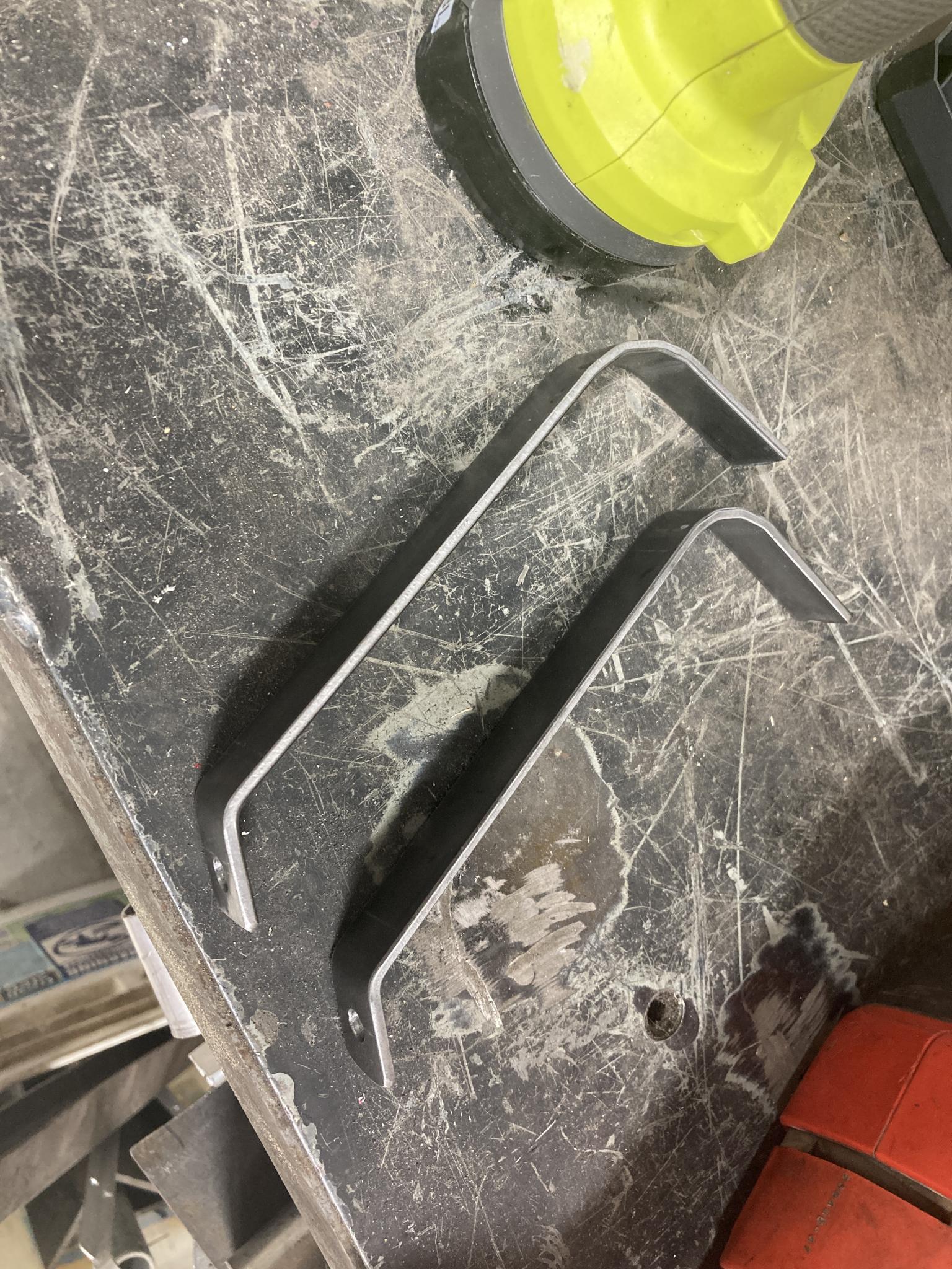

First, mount the amp. I added a couple of 1" straps running from the dash bar to the firewall so I could bolt it down. Even with the tack welds, it's one solidly mounted unit. Ideally I'd put it down low in the car to keep the CG as low as possible, but if we were going for pure function the car wouldn't have an amp! I mounted it horizontally like this mostly to keep it out of sight. Since I don't need access to it for anything, that's fine. It's just sitting on the mount, it's straight when done. Seriously.
