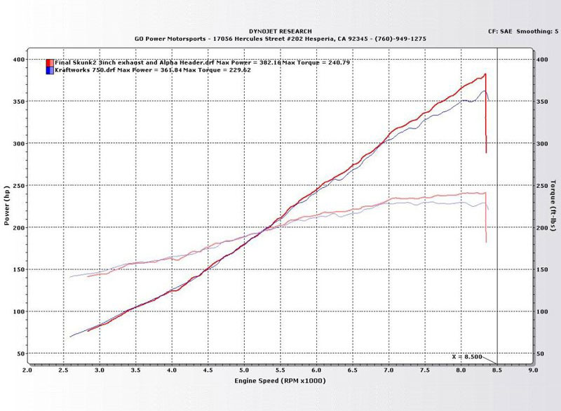

Uh, that's not what I'm saying.
The fact that in hp and lb-ft- the numerical value of power and torque are the same at 5250 is a function of the math, and not some kind of definition. And really isn't what is being asked.
What is being asked is if you can have peak power and peak torque at the same speed- 2000rpm, 4000rpm, 5250, 6000- where the max value is at the same location, not the same value.
For that to happen, it would be really hard, as torque would have to drop at a rate of 1/engine speed just to keep the power constant as engine speed went up. At some point, that happens, but near the peak torque engine speed- it's very hard to set an engine up to do that.
And the only way to do that using things other than spark or fuel restrictions is to have the breathing drop off that fast. It's just that air pumps are not that non-linear- to me that would require a point change in the airflow to happen- which in a real, physical world, does not make sense in my mind. Physics are pretty darned smooth- so to get onto a path that decreases faster than 1/N, you'd already have to be decreasing to do that. Which would mean you hit peak torque before that.
(remember, smooth means first and second order derivatives also can't have points- so the second derivative of air flow still has to be reasonable- not steady- but it won't have a point change)
The only real way you can make it happen is if there's an artificial limit- fuel for diesel or fuel and/or spark for gas.

edizzle89
edizzle89 Dork
12/7/16 8:49 a.m.
gearheadE30 wrote: Based on your plots, the ISF and QSF are tuned very differently.
that was also a random dyno sheet pulled off the interwebs of what seemed like a somewhat modified ISF swapped into a jeep. I dont know if the production ISF dyno sheet would look similar or not.
