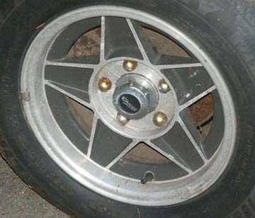

The better but more expensive way to go is to strip them to the metal and respray them so you aren't dependent on whatever quality the original coat might be.
I redid these myself (sorry the first one is not clean in the pic)
But had these professionally refinished and the result was great.
