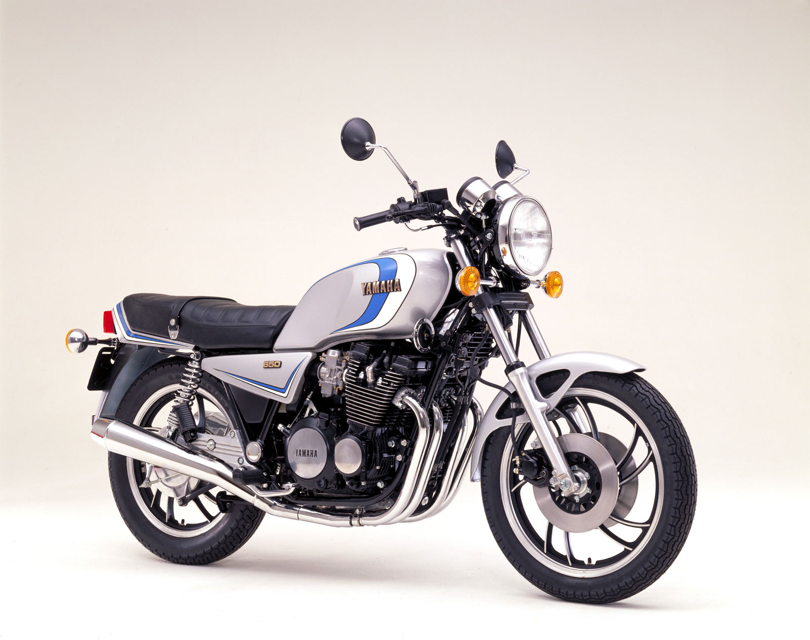

I'm thinking maybe something similar to the treatment on my Seca 650, but a little closer to grey instead of black.
Still need to figure out what to do with the top end, though.
