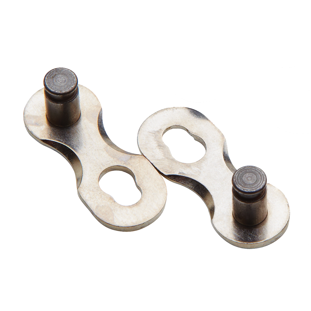

All the kids are riding with PowerLink chains these days (or something similar).
In theory, you can remove and replace them without tools, but sometimes it's easy and sometimes it's impossible. A pair of chain pliers will ensure that it's always easy.

I didn't say, "Don't bother with a chainbreaker", but once you remove that bad link, pop in a PowerLink to get you home. And you don't need pliers for that.

you gotta buy a new powerlink after you've taken it aprt ~4 times. still cheaper than buying a new chain...

Done (im)properly, you can pop off a powerlink chain in about 2 seconds using a regular ol pliers.  Just cross the jaws over the chain and give it a squeeze, make sure you go in the right direction to split it tho.
Reinstallation is simple too.  Get it close to lined up, position the power link between the rear wheel and the crank on top, step down on the pedal with the rear brake applied.  Boom.
