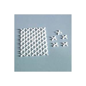

Spacers are your friend.

Use these or the gaps will never line up.

i hate spacers on floors but i've been doing it long enough i guess that i find them more annoying than helpful, especially if your tiles are not all exactly the same size.

Get those plastic corners to align the tiles. Ignore the bumps on the tile and their promise that they will line up right using them.

Those spacers are just a guide. If the floor or walls are a little wonky, and they will be, the spacers will get you into trouble. Use them on the first couple of rows. Use a chalk line to snap a few guidelines. Stand back an look at them. Adjust a necessary. The gaps may need to shrink or grow to satisfy the straight line.
