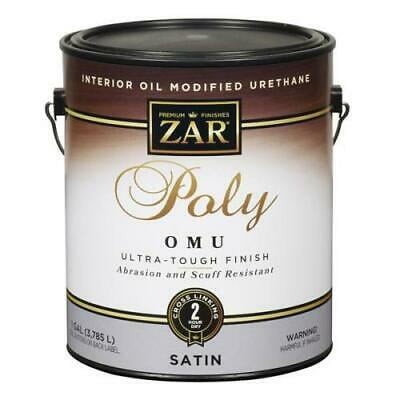

I went back and forth for days on oil vs water poly.  Oil has that soak-in ability which really makes the figure of the wood look 3D, but it also ambers wood, and the oils will get darker as the years go by.  Water poly doesn't darken the wood, but also lacks the ability to really give contrast to the grain.
I had pretty much decided on Zar "self leveling poly."  It seemed to have the least ambering, and rated as the hardest poly after it cures.  Unfortunately, the self-leveling part comes from additional solvents and high VOC which means I can only get quarts in PA.  I wasn't keen on spending $400 for a finish that meant moving out of the house for a week to avoid brain damage.
I went to Aumen's Paint in Palmyra PA, and spoke to [ironically, yet another] Derek.  We probably spent an hour talking about finishes.  He always keeps one pint or quart of everything he stocks as store use.  I had taken a scrap with me and we tried 6 or 7 finishes.  One came through hands down winner.  Zar OMU.  Oil modified urethane.  It is oil/alkyd urethane esters emulsified in a water base.  Just enough of the alkyd esters to make the grain pop without darkening.  Cures both my film drying and O2 crosslinking and supposedly very hard when cured.
Viscosity I would put right around melted butter or maple syrup.  On the thinner side of a typical oil poly and on the thicker side of a water poly
ZAR Ultra Max Satin Clear Polyurethane 1 gal.
