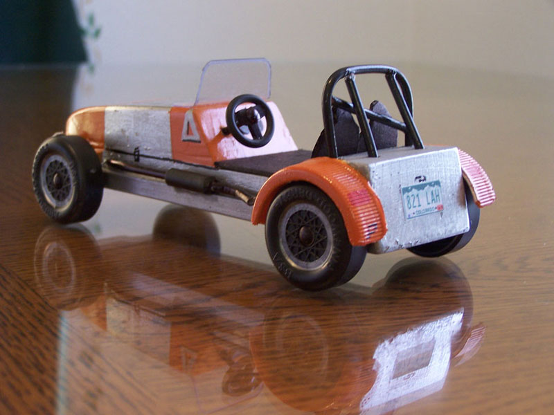

Put me in the "block of wood and four wheels" camp. We used to put graphite on the axles, but that's as close as I ever got to race prep other than making one look like a jellybean. I hand-carved a clumsy rendition of a 911 Cabrio for my really ambitious one. It wasn't that competitive, but I didn't care. It was cool and I still have it.
A racer friend of mine blew me away when he showed me the one built by his son. Now, Russ used to work at Pininfarina so he's got some skills. But he was also a great dad so I know the kids were involved. One son built a 1938 Auto Union, the other built this.
