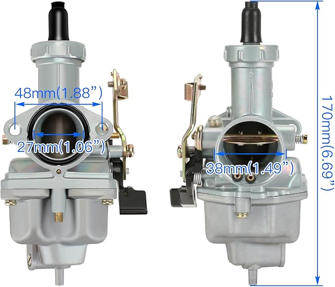

The carb is junk.  Jets are rusted in.  There's no saving it.  Before I order a stock Walbro 5-4993 we decided to look at slide style carbs like this PV27.
The problem is the mounting holes.  Where the PV27 is 48mm the original is 54mm.  I'm not bright so my google skills aren't working to find one with the wider bolt pattern.  Is there a trick?
EDIT - Looks like the stock replacement carbs show the bolt holes as 53mm not 54mm.

Turn the holes into slots and it would probably bolt on ....

Valid point.  Told ya I wasn't very smart.

You might be onto something.  I'm not sure how much the stock carb restricts things... you know, like outboards where the 75hp, 85hp, and 95hp versions differ only in carb CFM.... might that be true about a 5hp Briggs to a 6.5hp?
The PV you listed might be right, but you'll need to make sure it has both idle and secondary mixture adjustments.  A lot of the lawn and garden style carbs only have one mixture (if any) because they're designed to start and stay at 3600 rpm.  You'll also not likely see any gains unless you port match the intake to the TB of the carb... if it's bigger.

I ended up buying a stock replacement to just get the engine running without having to do a lot of mods.  If I use it for a mini bike or something I'll probably fab up a custom intake.
