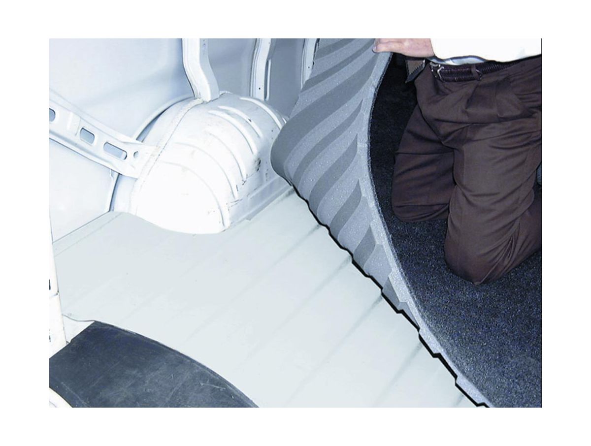

I've used BedRug in two vans and like it a lot. The BedRug for my E350 was shaped to fill the valleys in the floor. They offer a VanMat liner as well.
https://realtruck.com/b/bedrug/v/chevy/express-van/2006/

BedRug comes pre-cut, pre-formed, and pre-grooved. I've spilled water, oil, various cleaners, and gasoline, on it and they all just bead up and wipe off.
I'm not affiliated with them, I just love their product.
Bedrug 100% = way better than any DIY option and not that expensive.

The BedRug company also sells VanTred. Sounds like what you're looking for. I enjoy not spending $ too, but the fact that I didn't have to measure or cut anything to fit was what put me over the edge.
The BedRug isn't really a rug. There aren't fibers for things to soak into. I haven't had to wipe up grease though.
