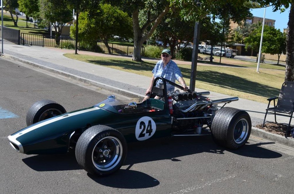

Here is what I'm talking about:
lotus-f1-67-replica
lotus-f1-67-replica

I think the audi v8 would be cheaper in the long run even with megasquirt and an ITB setup but definitely more complex. But if it's a nogo, then LS - ECU + carb/dizzy + https://www.kennedyeng.com + 01x

In reply to Torkel :
Lotus F1-67 Replica
Stuart Taylor Racing Ltd / England, Motorn: Chevrolet LS1 5.3 liter V8, Gearbox: 930 Turbo 4-speed,Price: €65,000
You forgot to mention that $$$$ is not an obstacle. They are asking $80k and my guess is the build cost was closer to twice that.
