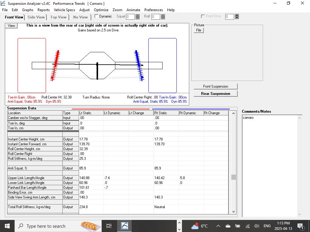

Here are screenshots from my suspension analyzer program, it plots all the important data points of the front and rear suspension. Units are in inches

I stiffened the dampers and increased the diff coast (to improve stability under braking) and the car is a lot better around the Nordschleife, I got it down to a 7:36 but I know there's at least another 3 seconds to take off. That bump steer it experiences is not present in the real car and I suspect it's because the sim version is still using 68 Camaro suspension geometry. Looking at the data, everything seems recorded in metric so I converted my measurements to metric and here they are
