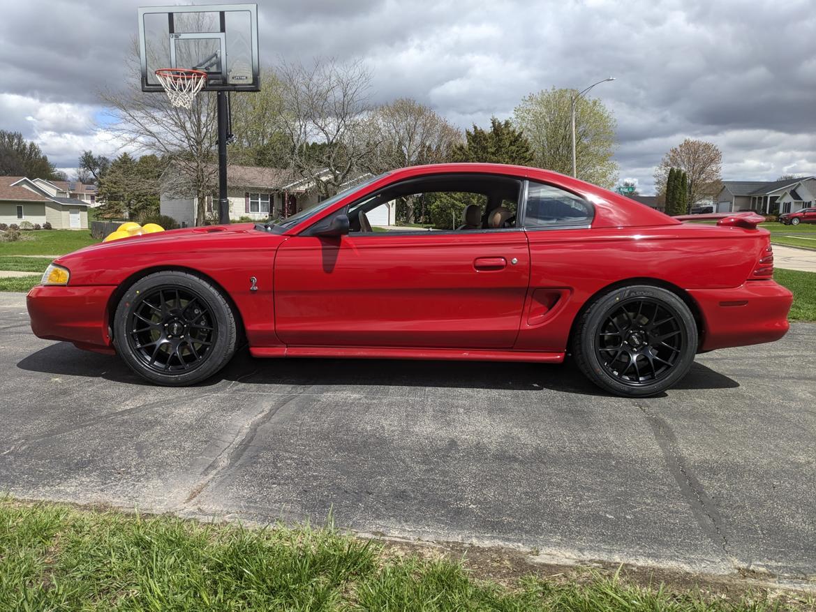

1994 Ford Mustang Cobra
Transmission Manual Mods - Handling Maximum motorsports k member, a arms, rear control arms, subframe connectors, panhard bar, torque arm, front and rear coil over kit with koni sports. 325# front springs. 200 # rear springs. Factory brakes with stainless steel brake lines and braided brake hoses. Apex EC7 18x9.5 wheels with 255/40/18 Yokohama Ad09 tires, 3.55 Ford racing gears with Eaton trutrac and strange 31 spline axles. Mods - Power Stock motor and heads. Trick flow valve springs. Ford racing 7 qt road race oil pan. Cold air and shorty headers. Bassani off road x pipe and cat back exhaust with dumps. Sullivan Products race pedals Mods - Exterior Na all OEM Mods - Interior Na all oem Background & Plans I bought it wrecked in 2012 and it was going to be parted out. I always wanted to save a car from the junkyard so I bought the car for $1,200 and has been a work in progress since.
