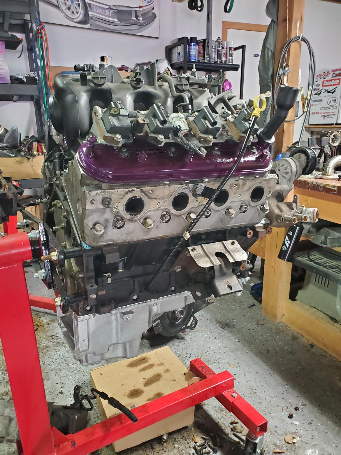

Quarantine isnt all bad. Had time to reassemble the rx7 motor. Just waiting on a few things like my fbody pan and its ready for the car.

Fbody oil pan kit installed. Motor and trans to go in the car this week!

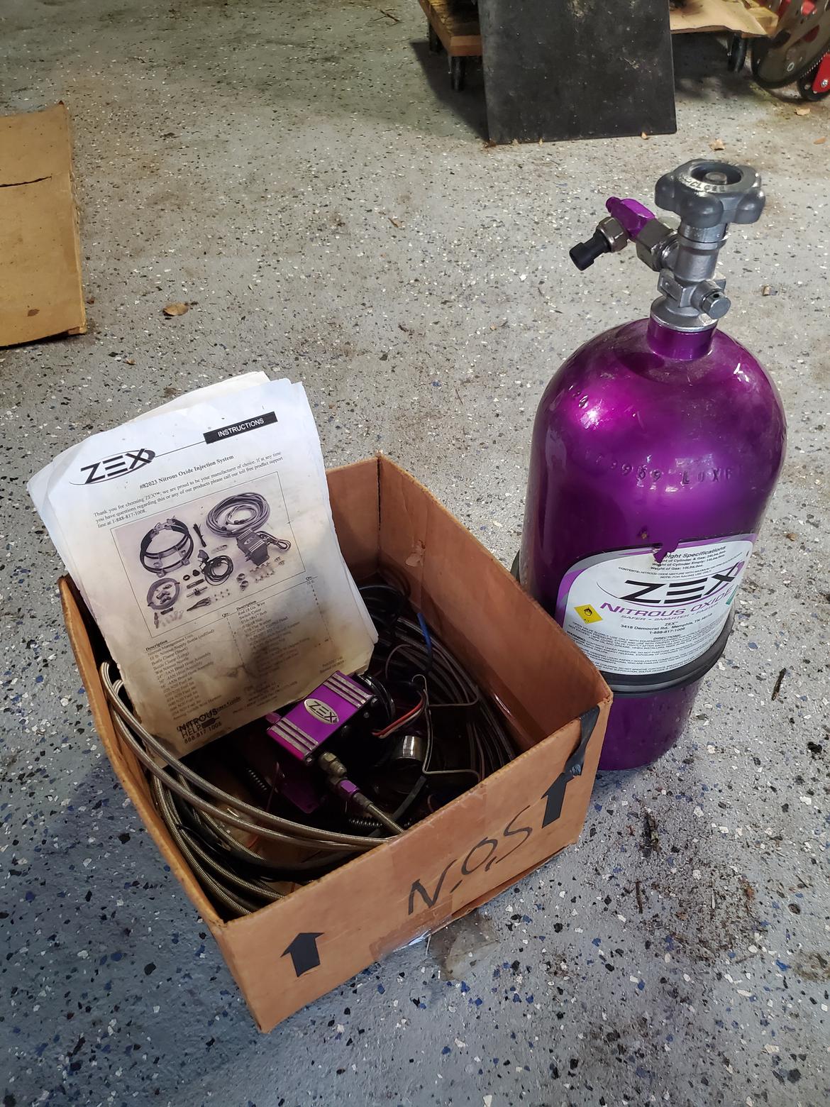

Nitrous kit picked up for $125.
