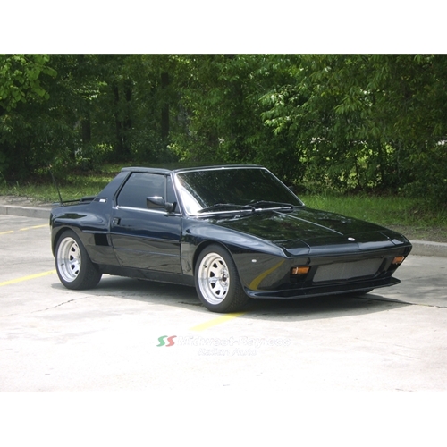

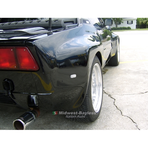

Oh and as far as wheel issues go, this is a potential solution:
http://www.midwest-bayless.com/p-7543-dallara-new-fiat-bertone-x19-body-kit-dallara-style-awesome.aspx
