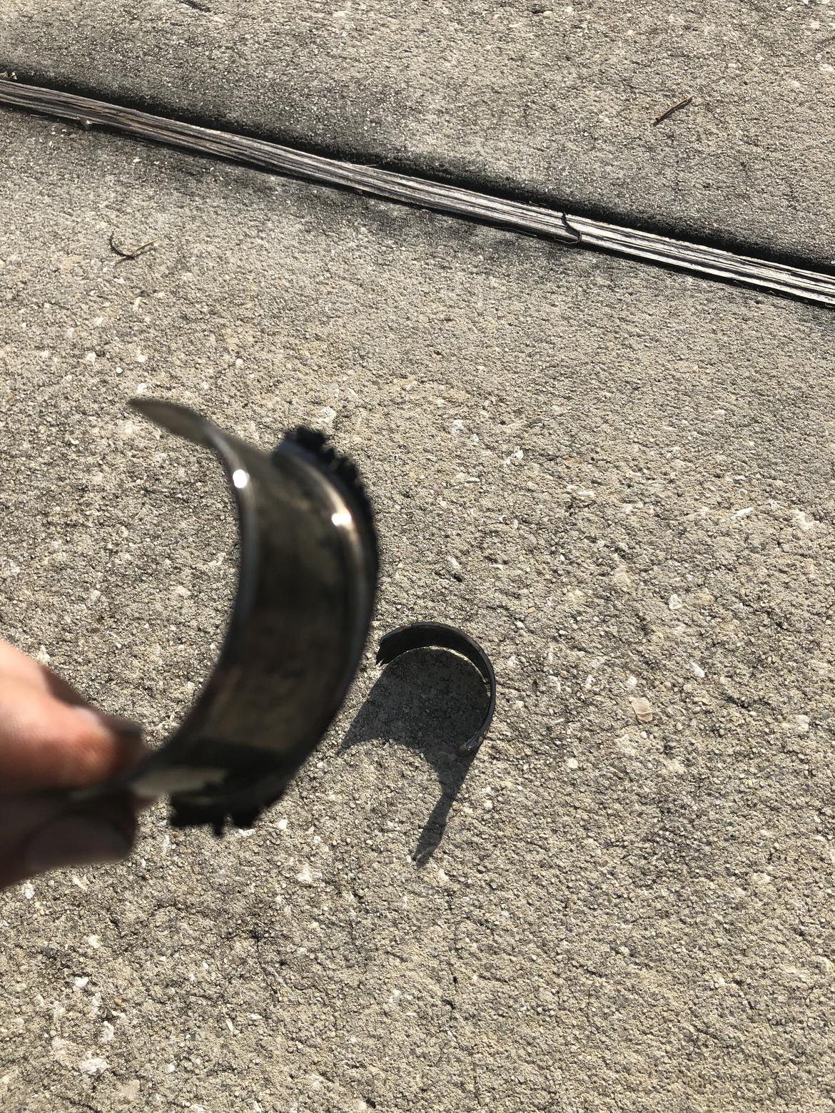

I finished pulling the Pistons out of the SBC and cylinders 1-6 are mint then comes cyl 7 and as a result cyl8.... Cyl7 spun a bearing (picture below) and as a result spun the bearing on cyl8 eating through the crank and rod.
*CAUTION Automotive guts below*
In case the blurry pictures deceive you the bearings were pushed out of the side of the rod where it sandwiched between the 7-8 rods and gave the bearings a 2mm lip...

Unless i can find a balanced rotating assembly for under $300 that i can swap into my block i have a trashed short block that will get parted, sold, junked, used as a lawn ornament, etc.
Now... Idk too well if i can ghetto machine the crank on that journal and use Oversized bearings on it reliably so let me know if it is possible to try to save this assembly.
