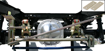

Any pics of the 5 link?

I don't have any pics of the 5-link, but it's one of these (just much dirtier and with aftermarket LCAs as well):

Are you running your upper arms in the upper mount hole or the lower mount hole; 98% or 65% anti-squat, respectively?
NONACK
NONACK Reader
5/3/14 8:44 p.m.
Upper- 98%
The choice had nothing to do with antisquat, however: with the springs removed, there seemed to be a lot less bind overall when articulating the axle and compressing the suspension with that setting.
