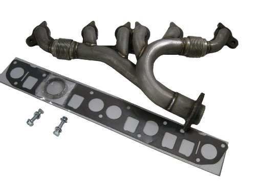

Yeah, most of the performance stuff you can get for other common engines are also available for the 4.0l, including several options for headers. The updated OE replacement tubular exhaust manifold isn't a super star performance wise, but does have expansion joints built in to stop you from having to worry about future cracks. Most of the usual companies offer a header though, if that's the route you decide to go.
But for less than $90, for an otherwise stock XJ, I'd probably just get one of these replacement manifolds. Notice the expansion joints for cylinder 1 and 6. Might be worth while to slather some exhaust or BBQ paint on it before installing.

Thanks for the header advice. It passed PA Inspection for mechanical and emissions, so that's a major hurdle overcome! The cracks in the header are not bothering me at this point, but I will deal with it eventually.
I went to the Pull-It yard today and grabbed a few things and looked at headers. Most were cracked already, but the newer models might yield a decent set. Probably wait till spring and pull one. I grabbed some trim pieces, and a new Oil Pressure Sending unit as the old one is leaking past the plug.
