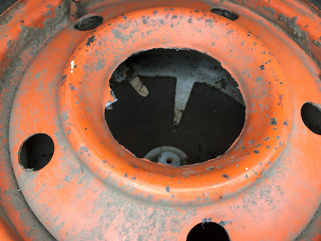

I did 2 years of rallyx on a set of steel wheels on our subaru with many drivers in the car every event without a problem....
Then this happened.
I bought a set of alloy wheels for that car right after that.
Since you are running stock class when looking at other cars wheels make sure they are the same width as your stock wheels and within the offset range for stock class.
