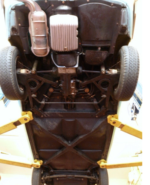

Oh hey guys, remember this project?
I had started in on the floor repairs and was frustrated by the limited access afforded by the lift so the suspension came off and I mounted it to the rotisserie.
Access is now much better
You can see in the first pic the rear floor is already out. Lots more to do though.
