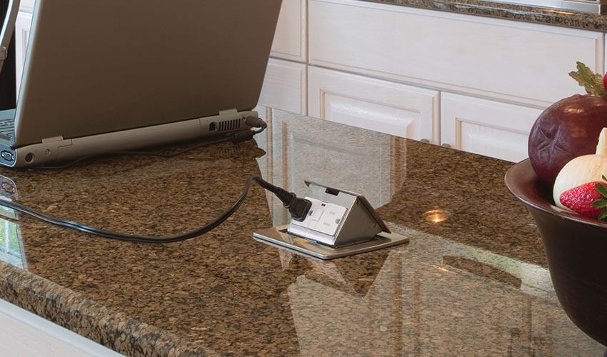

Another option for the power strips would be to do some pop-up or roll over outlets through the counter top. I was planning to do them on the island but decided to just do the cabinet side outlets.
These units from Mockett were ones I was going to use.
Lew Electric also has some nice flip style units - Link
