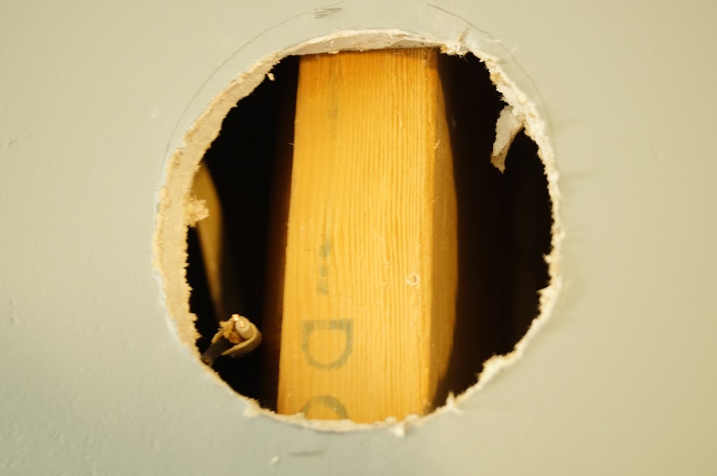

Next I start measuring out where the vanity would go, and where my light would be. So with a little hesitation, I cut into my freshly painted and patched walls.
Bingo, and my wiring is right where I planned it to be.
I mounted a shallow pancake box to the stud, then wired up the light and attached it to the pancake box.
