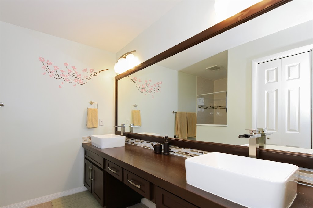

Enyar said: How to I keep missing these updates! Looks great! Question number 1: Care to describe the paint process for that vanity?
For the vanity prep I just hit it with some 320 sandpaper and then some red scotchbrite in the corners. I used spray cans to do it all. Painted with Krylon primer, then topped with Espresso Kyrlon Spray Enamel. Make sure to wear a respirator and if you have a window in there, try and get a fan in there to draw the fumes out.
