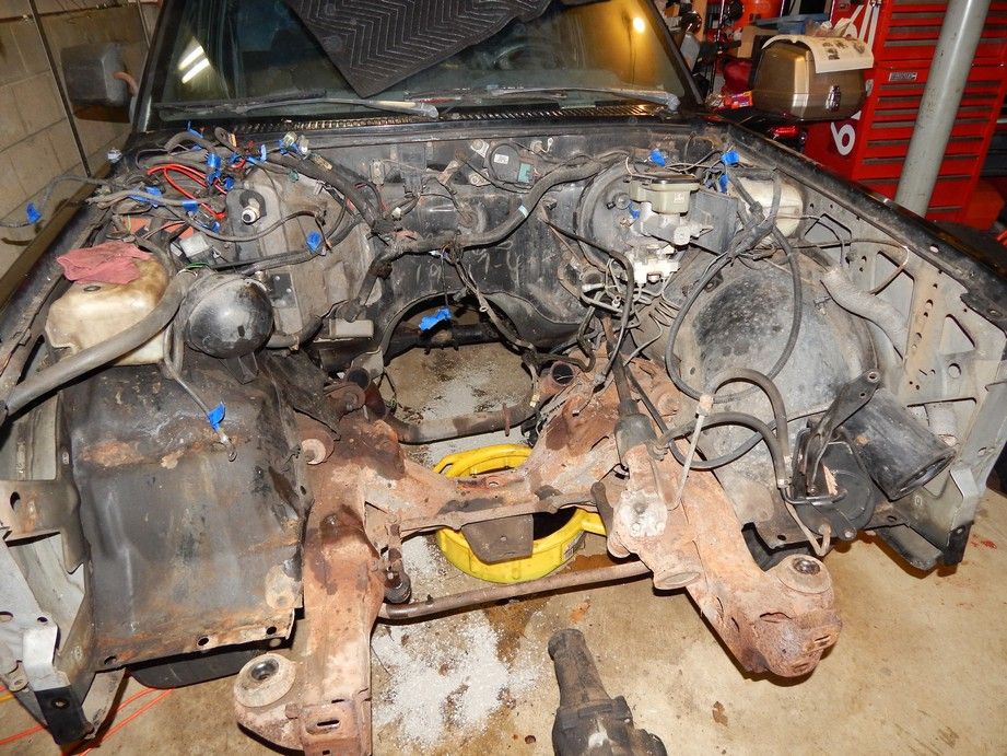

1/11/17 7:52 p.m.
And evidence of last night's destruction:
Need to pull a few things off the 4.3, then drag it to the front of the garage, and put it on CL.
I'm approaching something of a crossroads here, though. If I can confirm the engine/trans is good in the fireturd, I'll have a more solid idea of the costs of doing the swap, and thus will have an idea how much room I have for everything else. If I leave the engine stock-ish, I should have no problem buying suspension parts new, and installing them now, while the engine is out of the S10, and work will be a lot easier. I can also hope to find used/cheap parts down the road, which may or may not happen. I'm debating at this point whether to just go ahead and do the work I'd eventually do anyway (possibly after the challenge), and risk running a truck that'll do high 15s in the quarter mile at the challenge, or hope I can find cheap upgrades to the suspension, so I have room to build out the drivetrain for better performance.

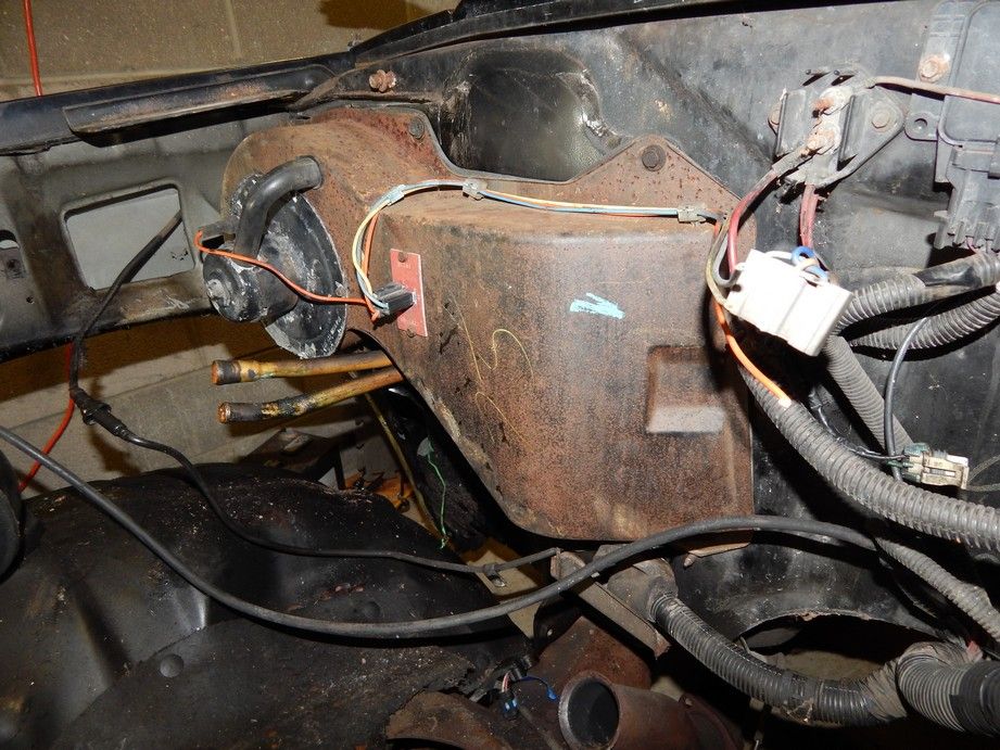

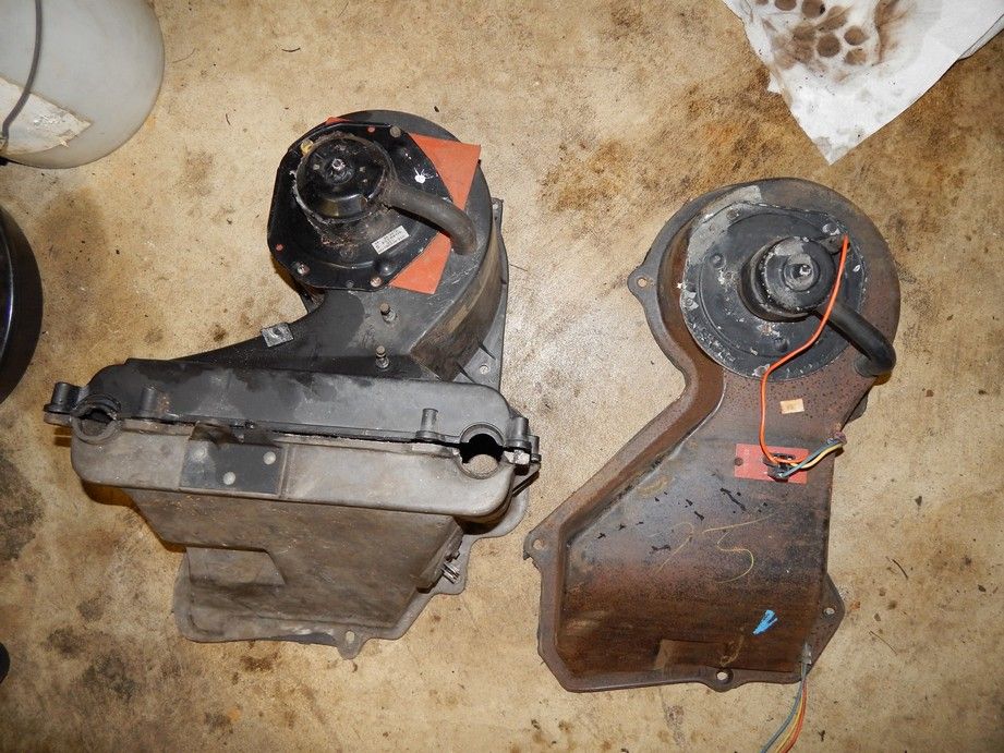

No more work done in the garage, but I went out in the somewhat dreary morning weather to the junkyard. Finally pulled a non-AC heater box, which should open up underhood space considerably. If nothing else, spark plug access will be a lot easier. I also grabbed the heater control, I can put it in after the challenge is over, and not have extra controls. Picked up a v-belt pulleyed alternator, not sure I'll use it, but it was cheap, and looked to be in good condition.
Finally, I grabbed a fuel injection assembly from a wrecked TBI pickup, in the hopes that it is all I need to get the fireturd running again.

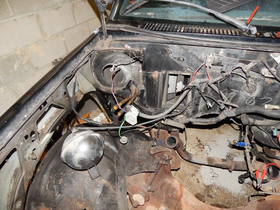

Time to add more room to the engine bay. Started with this:

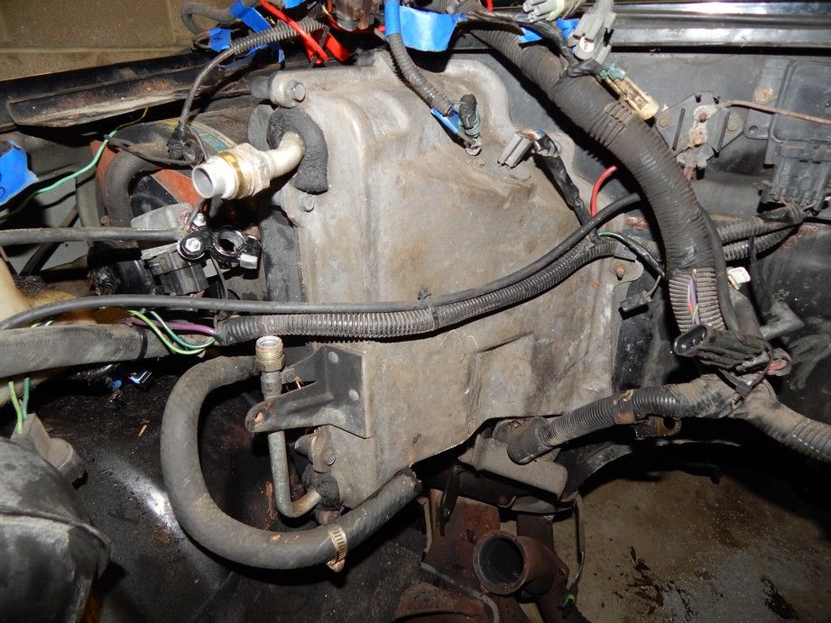

After spending a bunch of time unbolting the heater box, and incorrectly thinking it was held in by some bolts on the inside of the firewall, I managed to remove it. It also takes some prying to break it loose once it's unbolted:
Supposedly, if you keep air conditioning, you need to cut out part of the heater box to clear the right valve cover. However, switching to the non-AC heater box prevents this from being necessary. It takes up way less room:
It's really noticeable in a profile shot. Looks to be less than half as deep, when you don't take the blower motor into account.
For a test fit, I bolted it up to the car, and took a look. I'll pull it off to clean and repaint it later. I may bash in a corner of it as a bit of future proofing - If the engine is set back, it still needs to be clearanced for the valve cover. I plan on keeping the trans in the stock location for the challenge, but afterwards, may make some changes.

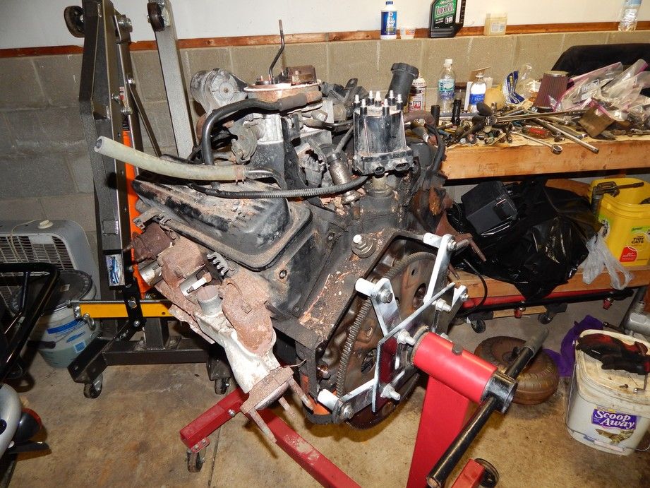

Other than that, I did some more cleaning up and pulled any pieces off the 4.3 I wanted to keep. Now, I just need to take a few pictures of the engine, and get it listed for sale.

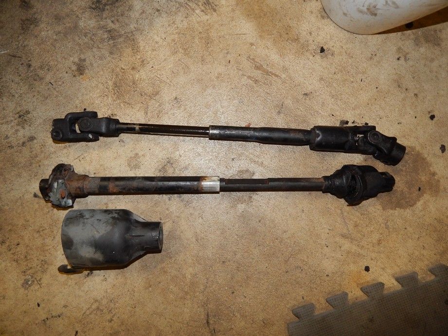

Today, I pulled the steering shaft in order to replace it with a Jeep Cherokee steering shaft. The reason behind this is the upper U-joint on the S10 steering shaft is fairly large, and can interfere with the V8 engine's exhaust manifold.
An additional bonus is it replaces the rag joint at the bottom with another U-joint, so it should get rid of a little bit of the slop in the steering. One item of note if you do this yourself, for the upper U-joint, it changes from a through bolt to a pinch bolt. The pinch bolt is just a smidge too big and rubs against the steering column shaft. Tapping it in a bit until it hits the threaded apart of the steering shaft seems to do the trick. However, when you tighten the bolt, the steering shaft wants to collapse slowly, and it risks sliding off the column. I was able to just push the steering shaft upwards while tightening the pinch bolt, and it held in place.
