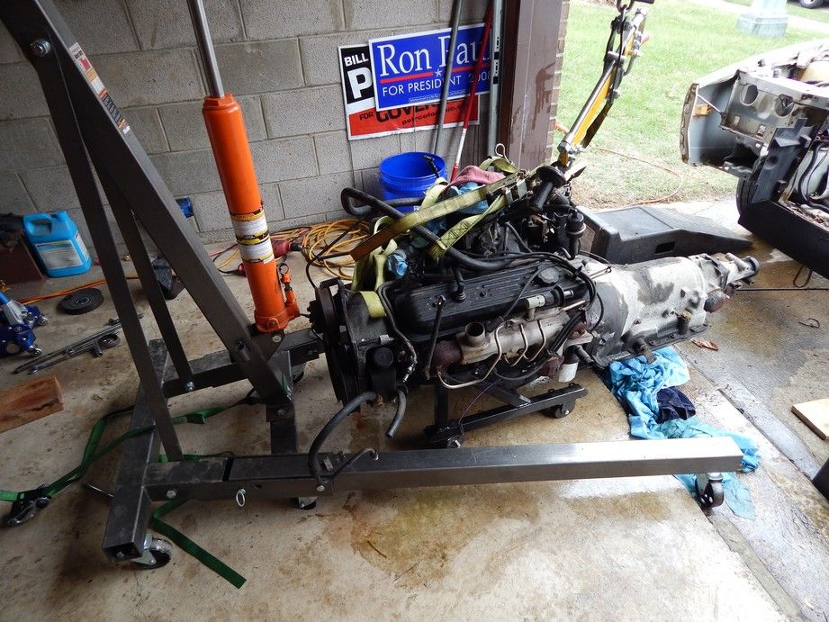

So, on Sunday, wae and I attacked the fireturd. Not many pictures, since we were racing the clock. I can say one thing for sure, I will never pull a car engine in the driveway of this house again. Had to do a few things that were a little too sketchy, safety-wise.

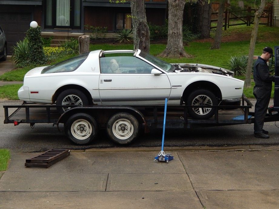

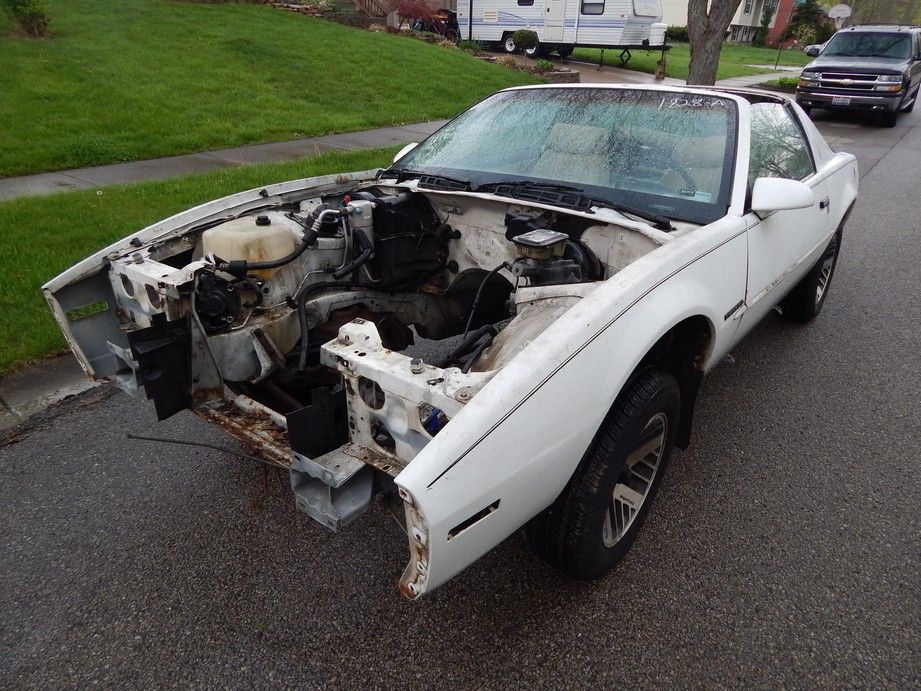

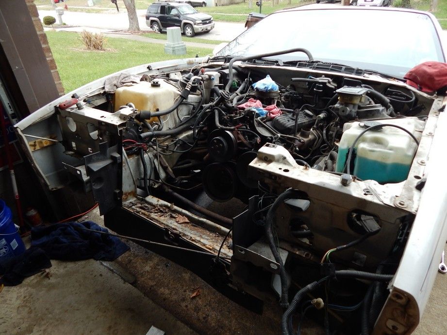

Once we had everything disconnected (we thought), I attacked the core support with a sawzall. Seems like the best way to pull the engine and trans together.
And, after figuring out that not everything (especially the AIR tube to the catalytic converter) was disconnected, we finally got to here:

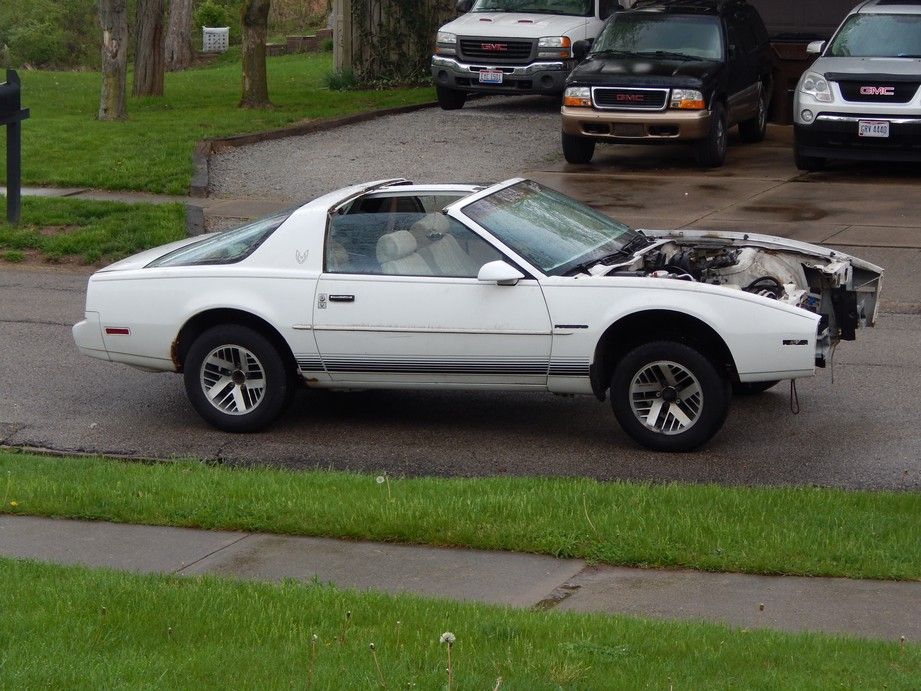

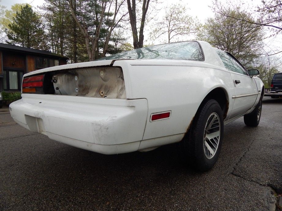

The fireturd weighs a bit less now:
I've got an ad on CL for parting it out. The hope is I manage to get $400 out of it ($375 purchase price + $25 auction fees). I'm also hoping to hit that point quickly, so we can haul the carcass off and no longer have it in my driveway.

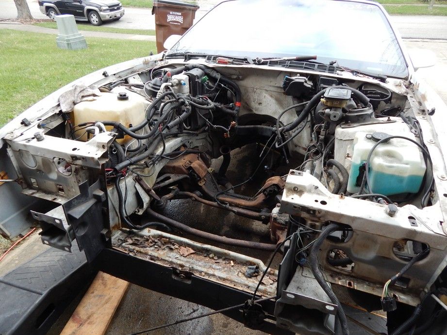

In better news, I managed to pull the ECM and main engine harness today, so those will probably go in the S10, if it stays fuel injected. I am thinking of pulling some more of the dash harness and other parts, since the gauges in the fireturd are nicer than in the S10.

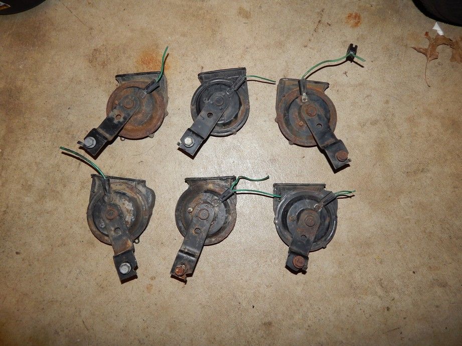

We ended up at the junkyard, and it turned out they were having a 40% off sale today. Mostly, we were seeking parts for the Riviera project, and while there was a 2WD Blazer there that I could have grabbed a rear axle from, it wasn't positraction, and we didn't really have a good way to haul it. I did go a little overboard once I realized horns were just a smidge over $2 each:
Full A C D F set, plus a couple of spares. At the very least, the S10 should get a nice four tone setup, and if I'm feeling really ridiculous, all these horns can be combined with what was already on the S10 and Fireturd, along with a few spare relays from the Fireturd's wiring harness, and the S10 will be very noticeable in traffic.

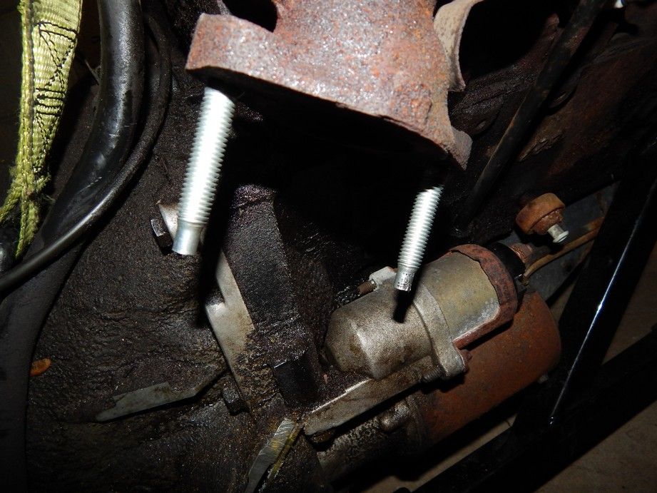

Now that the exhaust manifold adventure is over, I was able to chase the threads on the studs on the driver's side manifold, install new studs on the passenger side, and make a few other minor adjustments on the engine. It's pretty much ready to go in now.

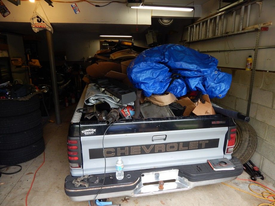

If you have hoarding tendencies, be forewarned, this is what your workspace/car could end up looking like when building a challenge car:
And that's only after hauling junk out of the garage:
On to the bad news. The engine is in the truck. Not normally what would be called bad news, but it took several hours, may have damaged a few parts, and it is not in correctly.
To get it most of the way in, I had to remove the passenger engine mount, and even then, couldn't get it lined up right. I think it is hanging up on the driver's side mount, but there just isn't much maneuvering room. I think I will try removing the transmission crossmember to get a little more wiggle room, but it may all need to come out and the engine and trans may need to go in separately.

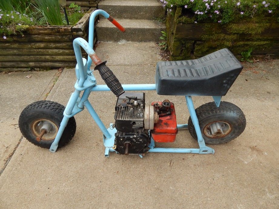

Nice vintage minibike frame with ape hangers, and a 5 HP flathead Briggs & Stratton engine, that supposedly runs, at least on starting fluid. The wheels/tires are pretty much trashed, so they likely won't get used, but who knows. If time allows, plan on seeing this thing at the challenge
