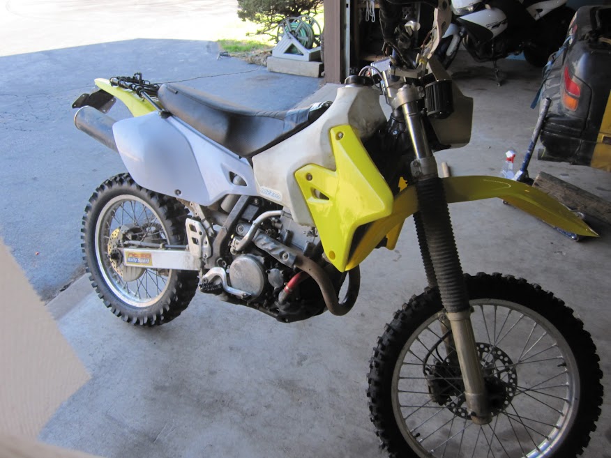

Unbasemented the bike:
We found that the best way to get it up the stairs with 3 people was to have one at the bars pushing, steering, and braking; one the the front tire rolling it up the steps, and one at the rear tire doing the same.
Installed tank, plastics, seat, battery, filled fluids:
The 2 into 1 fuel fitting broke, so I'm currently only able to use one petcock on the tank. Better that it broke here than in the middle of nowhere!
Then I fired it up, adjusted the cam chain tension, and went for a ride! It definitely picked up some midrange and low end power- it's not exactly a wheelie monster, but a good 20% bump in power is what the butt dyno says. I rode for about half an hour and changed the oil.
Some metal was present in the oil, but nothing really scary. The magnetic drain plug and magnet in the oil filter housing caught some particles too. The only thing that seems off about the bike is that the idle is still sort of funky- it tends to "hang" high and then drop later... but overall, I call this rebuild a success!
