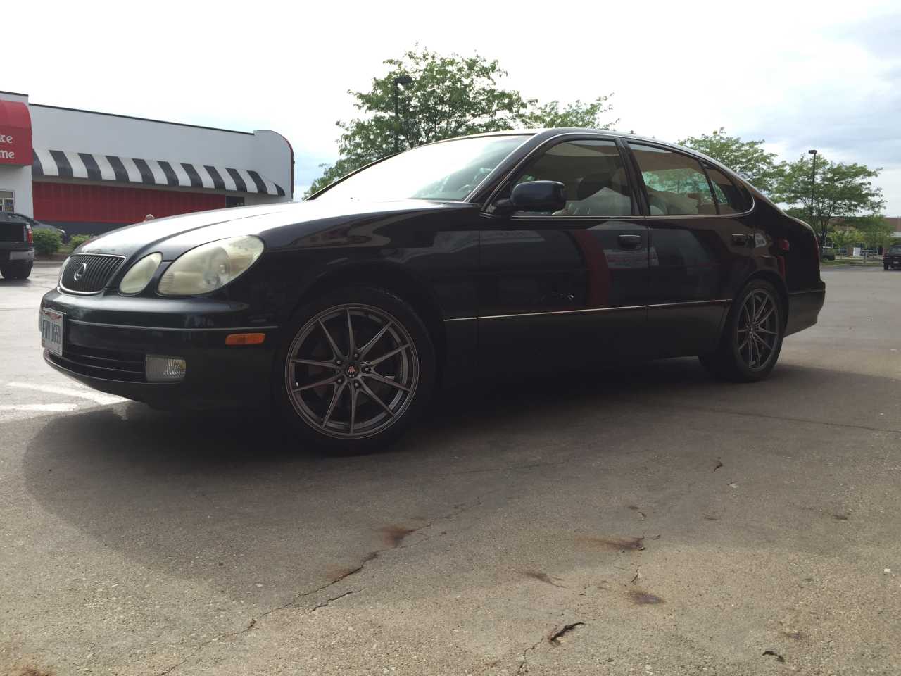

Let's see where I was when I decided to sell:
Not a bad starting point. It had terrible tires on it so I decided to upgrade those and the wheels first. Let me tell you, a nice set of wheels can make a car look good but a good set of tires can transform your car.

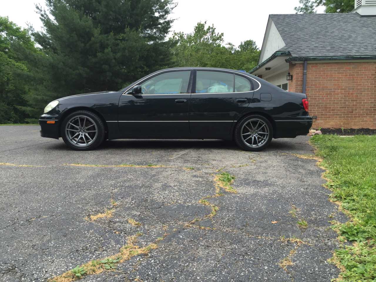

That's more like it. I chose Michelin AS3+ tires in 245/45-18 from Discount Tire and a set of Konig Understeers that I scored on Craigslist for a great price. What a difference that made! The car rides quieter, smoother, and grips like nothing else - well, compared to a worn 6 year old set of Uniroyal Tigerpaws. Yes, I probably put 50% of the car's sale value into wheels and tires, but it made the car feel completely different.
Unfortunately it also highlighted some needs in the suspension department. There was a slight dive to the left under breaking and a bit of a shake on the freeway. Checking things over revealed worn tie rod ends and a worn upper ball joint. Most of the front end parts are original with 261k miles on them, so I decided a comprehensive front end refresh was in order. As discussed here, I've always preferred factory parts, but they're shockingly expensive on Lexus and Toyota vehicles for some reason. Where we are now is that I've place a $1000 order with Rock Auto for every front end wear part they have, including shocks, plus front brakes. I went with Moog parts and hope I don't regret it.
