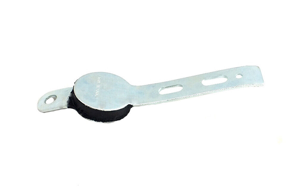

Shift linkage on an eight and a half is crazy simple. There is really only two items to go wrong and that is the shift coupler at the transaxle, and the bushing at the bottom of the lever
This little lolipop is just two pieces of steel with a bonded rubber pad in the middle. The bolts that connect it to the shift rod in the transmission are often loose and the rubber delaminating from the steel is common. You can drill through it and bolt it back together in a pinch.
The bushing at the lever is obvious.
Midwest Bayless has both for like $25 bones.
