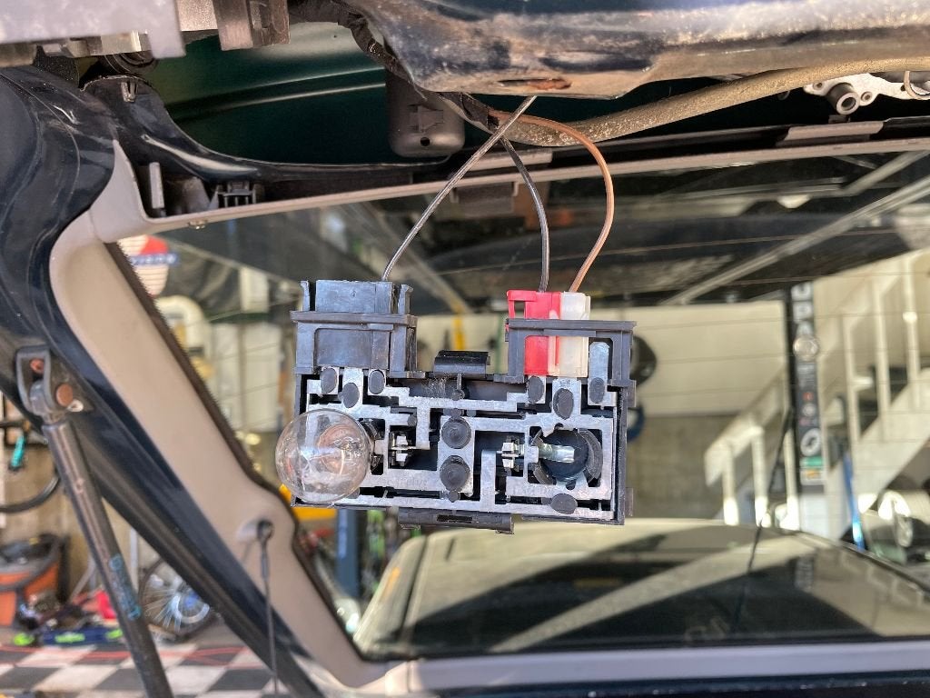

One thing I've been wanting to do is turn the unused rear fog light spots into additional brake lights.  I'd done this to my first corrado too.  Of course all the photo links on the VW Vortex threads were gone but I figured it out.
First remove the quarter turn fasteners.  I found these to be extremely fragile and easily stripped.  That gets you to the light housings.  Pinch the black clips on either side to remove the bulb housing.
Top bulb is my reverse bulb.  Put in a single filament bulb in the other spot, that'll be for your brake light.  Like this.

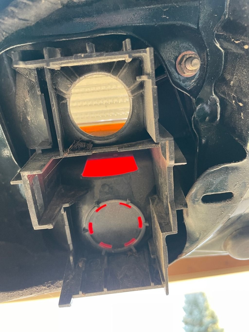

Here's what you see on the light housing itself.  It's held in place by 3 8mm nuts.  One of the nuts is hiding underneath the black rubber plug on the outside corner of the hatch.
You can see the black plastic "plug" you need to remove.  Remove the housing from the hatch and remove the plug.  Either a hole saw or a knife.  I used a utility knife, the plastic is very thin and easily pops apart.  Be careful not to damage the housing.  This is what you want.
Now reinstall the housings into the hatch of the car.  Time to do some wiring.  You need to trace the leads on the back of the light fixtures to see where to tap.  This was really easy on my drivers side, I only had one open connector, so that's the one I used.  A female spade connector works fine.  Wire both sides of the light housing, bring them to the middle of the hatch.
Passenger side wiring
Ok, connect the two wires into a single wire going up to the 3rd brake light.  You want to tap the black with red stripe wire off the 3rd brake light.
I unplugged this to get proper access to tap it.  Plugging it back in is a PITA as access is tight.
Here's all my wiring done, I ended up removing the solder/heat shrink to properly solder my connection together.
And the final result.
