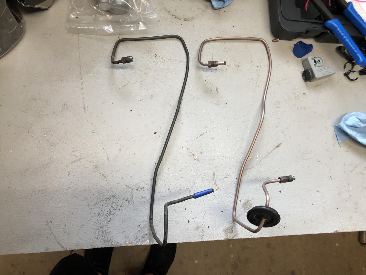

With the suspension still a half clusterberkeley.  I decided to turn my attention to the brakes.  The pedal was spongy with a hard braking event towards the floor, and the MC was leaking.  I had picked up a spare a while back, but I was unable to the LF bake line was stripped out, and wouldn't even turn with vice grips.  Knowing I'd have to cut the line to remove the MC, I resigned myself to making a new brake line.  So I ordered a some 3/16 NiCopp brake line, a brake benders, and a flare tool from Eastwood.
I did a few test pieces, and it looked like it matched OEM fairly well!
With that checking out, I went ahead and started bending my first brake line.  Using the OEM one as a guide, I flared the start, and went bend by bend along the line....  when I got towards the end, I even remembered to add the fitting and grommet.... however, the last bit was a tight turn in three axis, and when I went to fit it up to flare the end, it wouldn't fit in the die.   So I started un-bending, and the copper broke.
Gave up for the night, and I'll tackle it tomorrow.  I think now that I've got a length, I'll flare both ends first on a straight bit, then bend.

Try to find some less aggressive ways to hold and bend the line - I see a lot of gouging.
there is a really cool pliers-style bender that I learned about not too long ago and love them. great for short tight bends
like these:
https://www.amazon.com/Lisle-44150-Tubing-Bender-Pliers/dp/B0027AL3X4/ref=asc_df_B0027AL3X4/?tag=hyprod-20&linkCode=df0&hvadid=309807921328&hvpos=&hvnetw=g&hvrand=14498968534108251158&hvpone=&hvptwo=&hvqmt=&hvdev=m&hvdvcmdl=&hvlocint=&hvlocphy=9031008&hvtargid=pla-570676419735&psc=1

Thanks for the tip, I did pick up some of those when I was spending way too much money at Eastwood:
There's almost certainly some user error involved here, I was able to do the gentle and sweeping bends by hand, but then the tighter ones were done with the pliers, it was tricky to ensure I had the plane of bend right as I was going through, I think maybe there was too much play in the clenched diameter, because the tube wasn't tangential coming out of the bend as I was forming them.
I was able to crank out one the second attempt fairly easily. I used some string to get the length, cut the length first, added both fittings and the grommet, then flared each end, and bent it up.  Fitment was good enough to do some final tweaks in place.
With this new line, I could install the new Master Cylinder and new line:
Spent some time bleeding a whole bottle through the system with my Motive Pressure Bleeder...  Success!?   Or not, pedal is still just as spongy.  Not sure what else to fix, I'm thinking my next attack will likely be to refurbish the OEM vacuum booster, and swap out the weird aftermarket one that was leaking.
