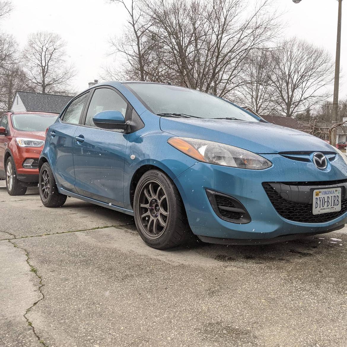

Playing around with sway bars this week, I am robbing the 15x7 Advantis with Conti ECS off of Blueboy (and put some 15x7.5 TRM C1s on it with worn out 195 RS4s to hold it up in the meantime) in case Sunday rains and snows at VIR like is currently in the forecast.
Running VIR Full Course Saturday, North Course Sunday... Can't wait!
