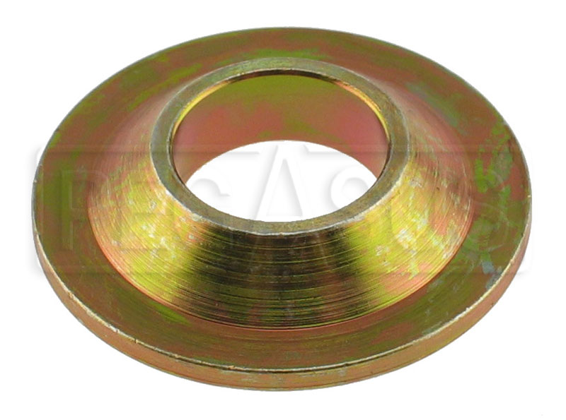

I'd like to request a few pics of that roll center correcting monoball joint on the bottom of the front spindle/carrier. Wondering what it looks like on top of where it goes into the spindle. Is there any kind of 'head' on top or is it just held in there like the stock ball joint?

jgrewe wrote: I'd like to request a few pics of that roll center correcting monoball joint on the bottom of the front spindle/carrier. Wondering what it looks like on top of where it goes into the spindle. Is there any kind of 'head' on top or is it just held in there like the stock ball joint?
Do you mean this thing?
bgkast
bgkast Dork
4/10/14 9:23 a.m.
It should have one of these for safety.
teamilluminata
teamilluminata Reader
4/10/14 2:25 p.m.
bgkast wrote: It should have one of these for safety.
What does that do?
