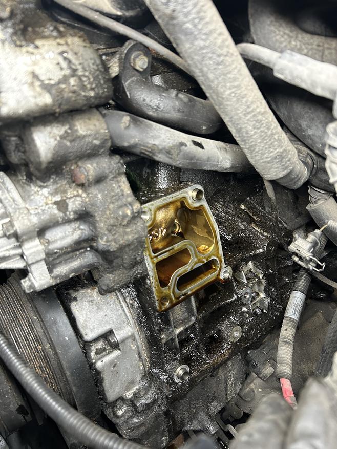

Welder out and stripped bolt out tonight. Got the alternator off, which let me pull the oil filter housing!
definitely leaking from there, but I'm wondering if some of the leak isn't also from the vanos hose connection(s), as a lot of the oil looks to be too high to be from the OFH, and the valve cover is dry.
and the old vs new gasket - clear difference in thickness!
