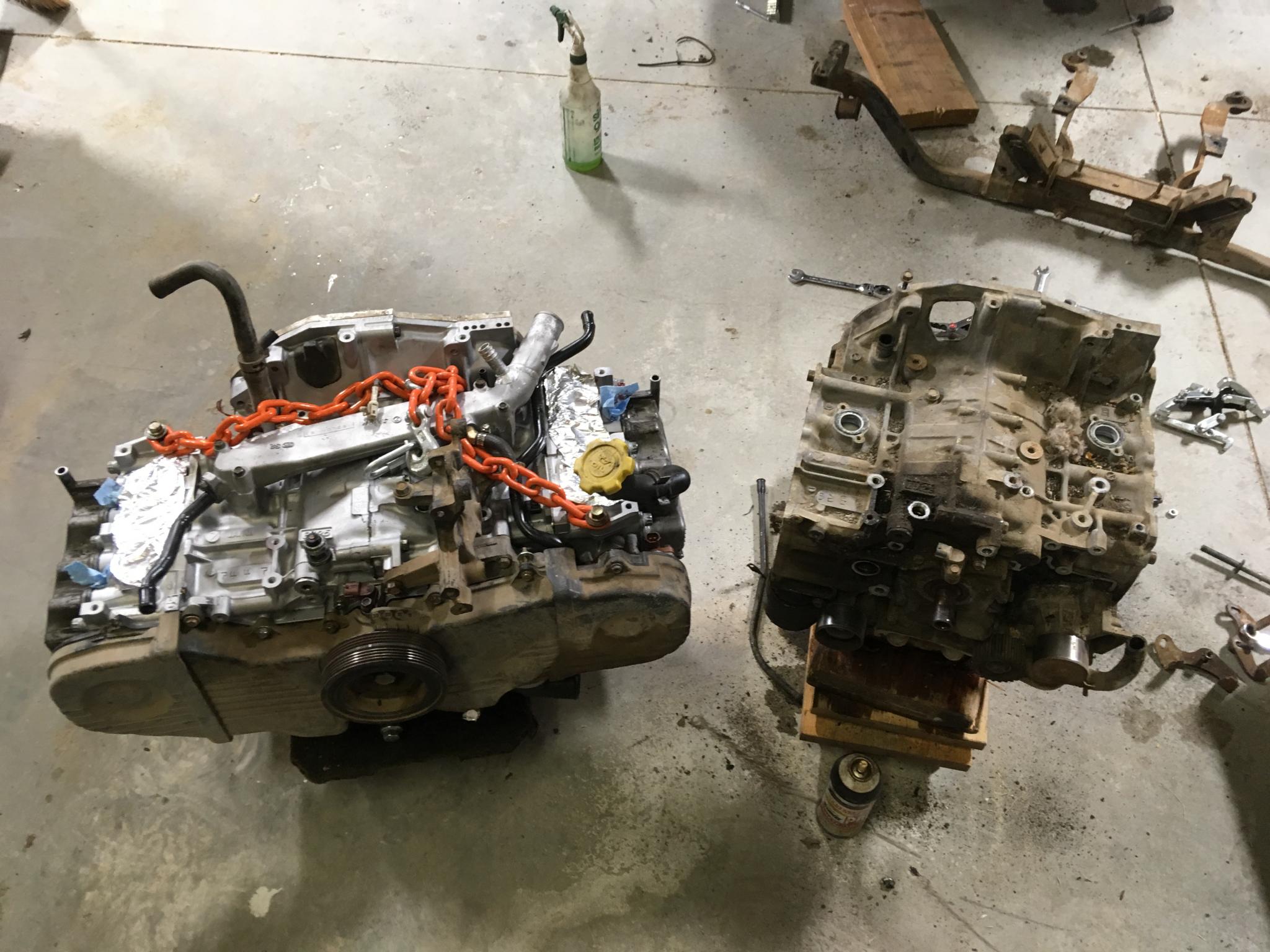

I was using the shop to do Real Work this weekend - building an engine, pulling an engine and modifying the engine mounts to suit some new parts. Cutting, grinding, bead blasting, assembly, hoisting...it's working well. I even reconfigured my space by wheeling one of my big wheely workbenches to a different area. Once I'm done with this job, I'll spend a day simply cleaning/tidying up and it'll be ready to show off.

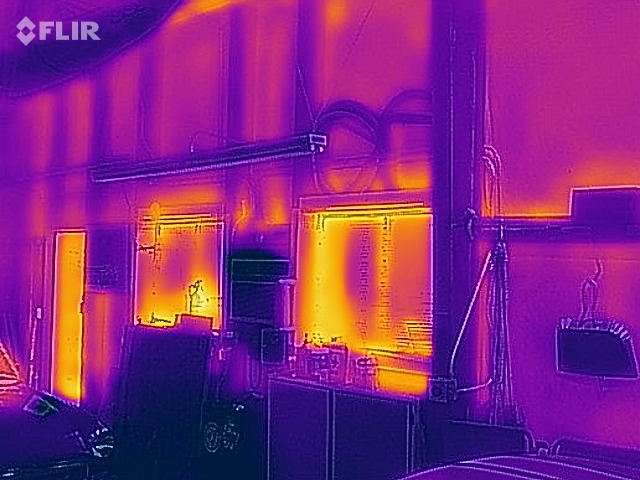

But the AC is still struggling. It was around 80F in the shop this weekend with highs close to 100F outside. The AC unit just can't do the job. I did discover that there's a real temperature gradient as you move around the shop - near the doors, it's cooler than it is at the back where my workbench is. This is probably due to the fact that the AC unit is in the front half of the garage and the fan only blows up and down. A small fan at the front aiming towards the back may help that. Wouldn't take much.
I was looking at ways to cut down on heat gain on the roof, but a quick look around with the FLIR showed me this.
That's the west wall in late afternoon. The door is currently open, but check out how much heat is coming through the windows relative to the walls. The sun hammers this wall all afternoon. So I've ordered some reflective film for the windows to see if I can keep that heat out in the first place. Some sort of carport along that wall would also help a lot by shading it and give my poor outside cars somewhere to sleep. It's also possible that the FLIR is reading some of the visible light coming through those windows. But the window film is cheap and easy so it's job 1 :)

Now for a gratuitous photo of the work that was done this weekend, just to remind myself that even if I didn't get it finished I did get a lot done. It was a weekend of problems encountered and overcome.
7/10/19 10:40 a.m.
I have pimped out the shop! Or whatever the kids say. We have tint.
This is BDF window film sourced from Amazon. Specifically, the EXS15 exterior film. The idea is to prevent the heat from getting in at all. This is a pretty dark tint, I use the 30 on house windows but these windows aren’t really for the view.

How much did it drop the heat transfer through the windows?
7/10/19 11:50 a.m.
Dont know yet, the sun hasn’t hit the windows yet :) I’ll bring out the FLIR later. At the very least, it made the shop look less junky.

7/10/19 9:49 p.m.
I’m having trouble with the FLIR autoranging, but it does appear the windows are now much closer in temp to the rest of the wall. So I’m going to call that a win. The AC is also running less.

I'm not entirely sure what winter is like at your elevation, but what will that mirror tint do in the winter? Light and or heat wise? Seeing how low cost it is is giving me ideas.
7/11/19 11:12 a.m.
Well, I'm Canadian so I consider the winter mild. I'm not 100% sure the shop actually froze this past winter, between the solar energy and the insulated building I think it stayed just above freezing.
 The mirror tint will cut down on solar gain - that's what it's for! - but that's less of a concern than the blasting heat in the summer around here.  The windows don't really let enough light in to be useful as the only source of light, so darkness in the winter months isn't that big a deal.
