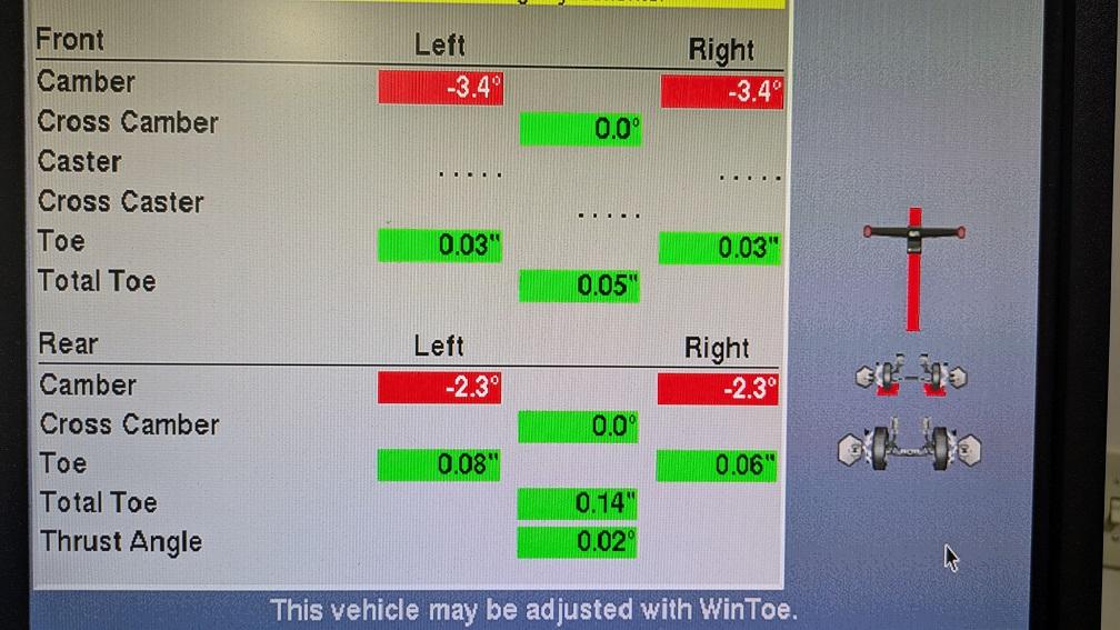

Put everything back together and did my best at setting camber back to what it was and the tie rod length correctly so that I could drive to do an alignment without dying or wrecking the front tires. Turns out I way missed on total toe and it was something like a quarter inch off, but the steering wheel was straighter than some purposeful alignments I've done. I also loosened the left tie rod end and moved it through a bit of travel to make sure I wouldn't run into any issues during the alignment process so I guess i missed equally on resetting both sides.
After a bit of effort to get everything even, this is the alignment I ended up with. I also changed from slight toe out to slight toe in in the hopes of not being too hard on the tires with the extra camber.

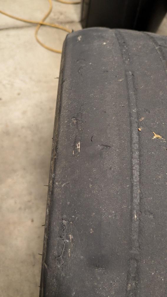

And upon arriving home I found this on the right front tire...I don't think I can blame my performance on this entirely but it certainly wasn't helping. Time to give in and mount the new tires.
