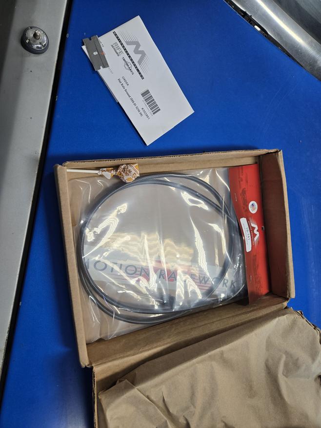

Working throttle
Working shift linkage
Mounted Nissan Armada rear shocks
More details Here
