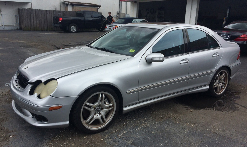

Here's what the car looked like at the dealership.
So right off I knew I would be needing some new headlights, grill, hood and front bumper with all the grills and fog lights. It took me a while but I was finally able to track down a silver hood, and front bumper with all the grills accessories intact, but Mercedes parts don't come cheap, these set me back about $1900, but thankfully they had another salvage yard 2 hours closer to my house that they shipped them to for free.

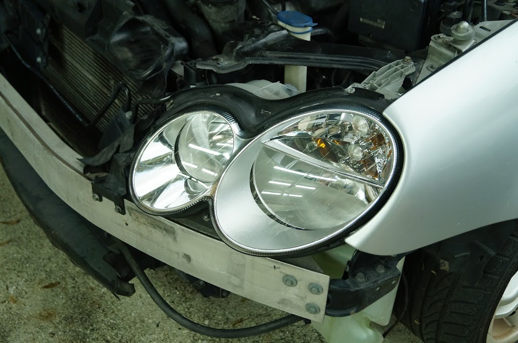

One of the new(used) headlights installed, I had to tweak the upper mount a little but the fit looks good.
