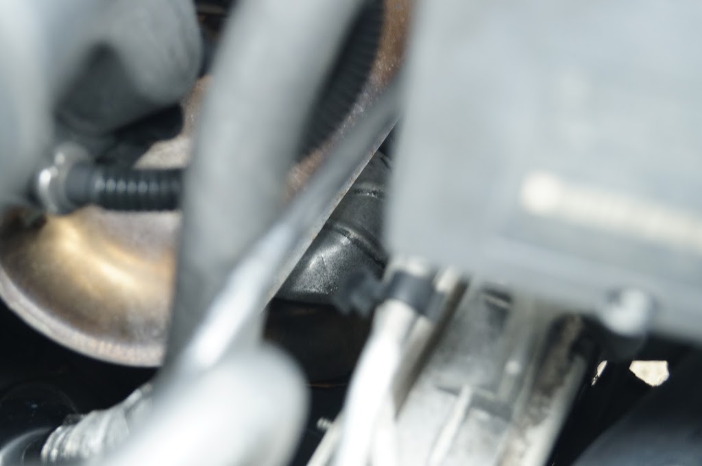

I tried to take a picture of the old mount in the car but it's far too buried to get a good shot of. It's the sliver looking thing in the middle.
So at this point it was obvious the air filter assembly would need to go, to grant me room to work.
That's better. I also jacked the engine up about 1.5 inches. Here you can see the passenger side mount.
and here's the drivers side buried in there.

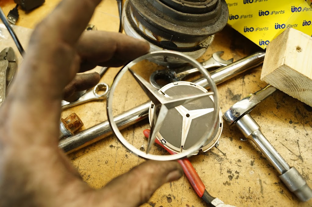

The last thing to do today was make a new Star badge for the engine cover. I had those leftover wheel centers, and they were just about the right size. So, a little trimming and I have a removed star.
I stole a book end from the wife's office next.. shh don't tell her. and cut out the mesh, glued it to the back of the cover with some shoe-goo. then attached the star tot he front with some super glue. I think it turned out pretty good.
And here it is installed on the car. Looks pretty sweet, and very much like the original mesh star that was there.
