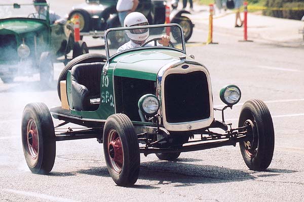

The goal is to end up with a fenderless, V8 Speedster that looks something like this one from the front...
...and this from behind...
...with a bunch of our own ideas mixed in along the way.
