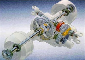

iceracer wrote: What is a "forward rear axle ?"
I would guess a dump truck, or other large truck with multiple rear axles. Honestly though, a guess only.

In reply to mistanfo:
yeah its for tractor trailers. Interaxle differential, power dividers, tandem axles, various other names.
big go big boom
