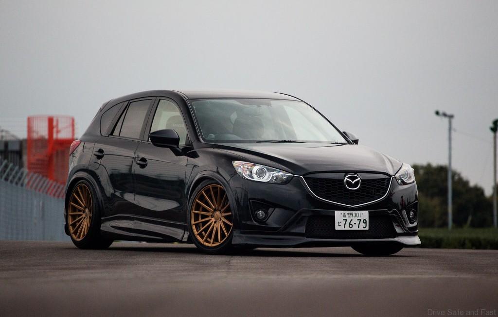

CyberEric said:
It looks like the CX-5 is still Mazdas money maker.
I don't need an extra garage, I need a extra warehouse for all the builds I wish I could dabble with

Your welcome to swap the I6 when you build that CX5
